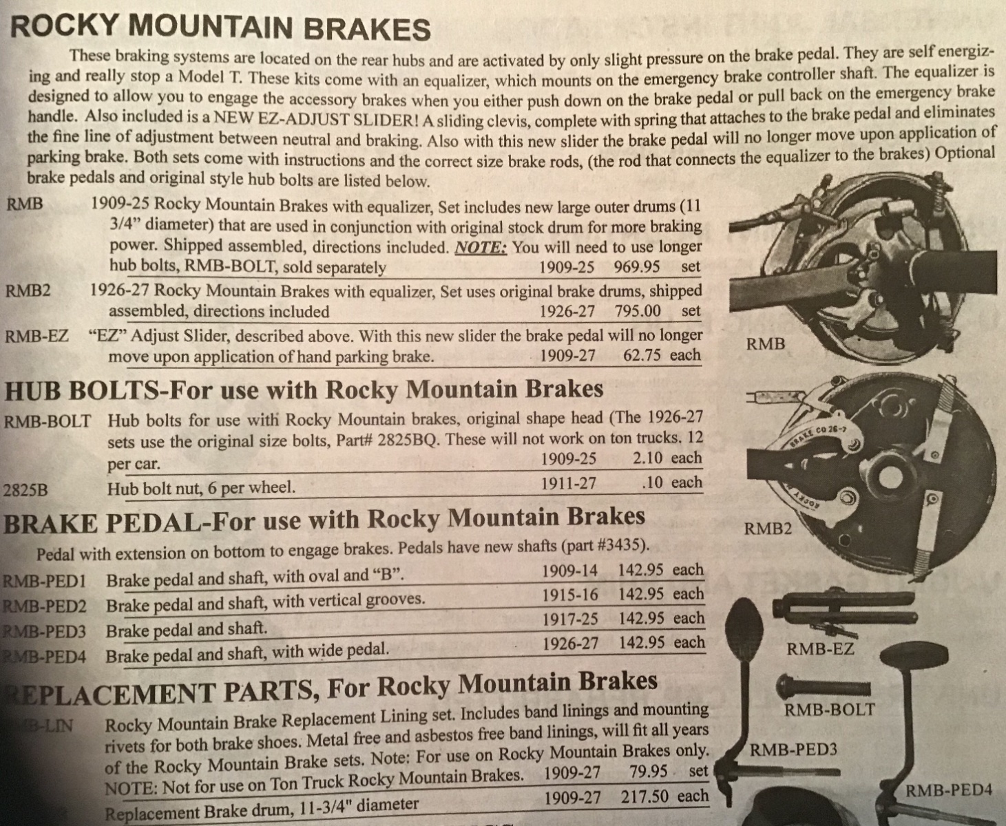

i am planing to buy Rocky Mountain brakes for my 1925 Runabout. Where is it the best way to buy? Are the systems all the same?

The R-M brakes are the version with the large drum added to the rear wheel, so very good surface area for stops.
For your small drum axle get the set with the large outer drum, your normal small drum is retained but sandwiched inside the new RM drum.
Obtain from suppliers like Lang’s, which may have them in stock, or direct from the mfg. at a savings, while shipping may delay from the mfg, as these are made on order and the mfg. might be slower on international shipment.

The Rocky Mountain Brake’s made in RMB Company in Temecula are NOT made to order, they are made in quite large (~100) batches. I was there one time when a large box of drums were delivered. Most times are in stock and ready for shipment.

Thanks a lot for the fast Information. Will measure the Diameter of my drums and then order at Langs.
