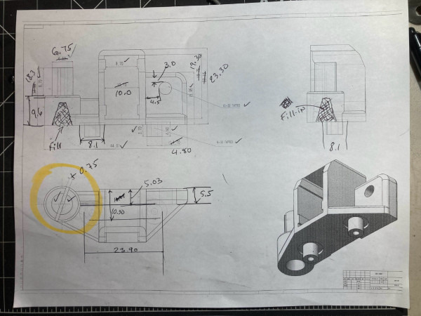

After rebuilding 100's of starter & generator brush holders and seeing what is available for replacements (they suck) I bit the bullet and decided have a casting made. I'm taking one for the team here. It's not cheap and is VERY time consuming, but these parts are failing more and more frequently, and somebody had to do it. All I can say is I'm glad I did well in most of my mechanical engineering classes. This is NOT easy. Round one is done as a proof of concept, but some adjustments still need to be made.
Here's the initial drawing. Lots of edits before we went to the mold. A couple important mods - I filled in the bottom of the often failing spring stantion for a little more support and made the brush wire screw (so often stripped) surface slightly thicker. I also drilled and tapped the 2 #6 mounting holes so it will be hyper easy to install these.
We're using zinc (as original) for the material.

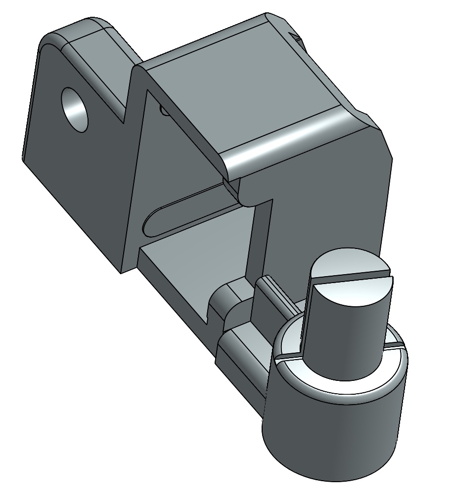

. 3D renderings .

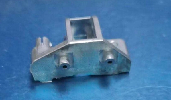

First mold pop Unfortunately the engineer made a mistake and the spring holder diameter is a bit too big, but everything else is good to go.

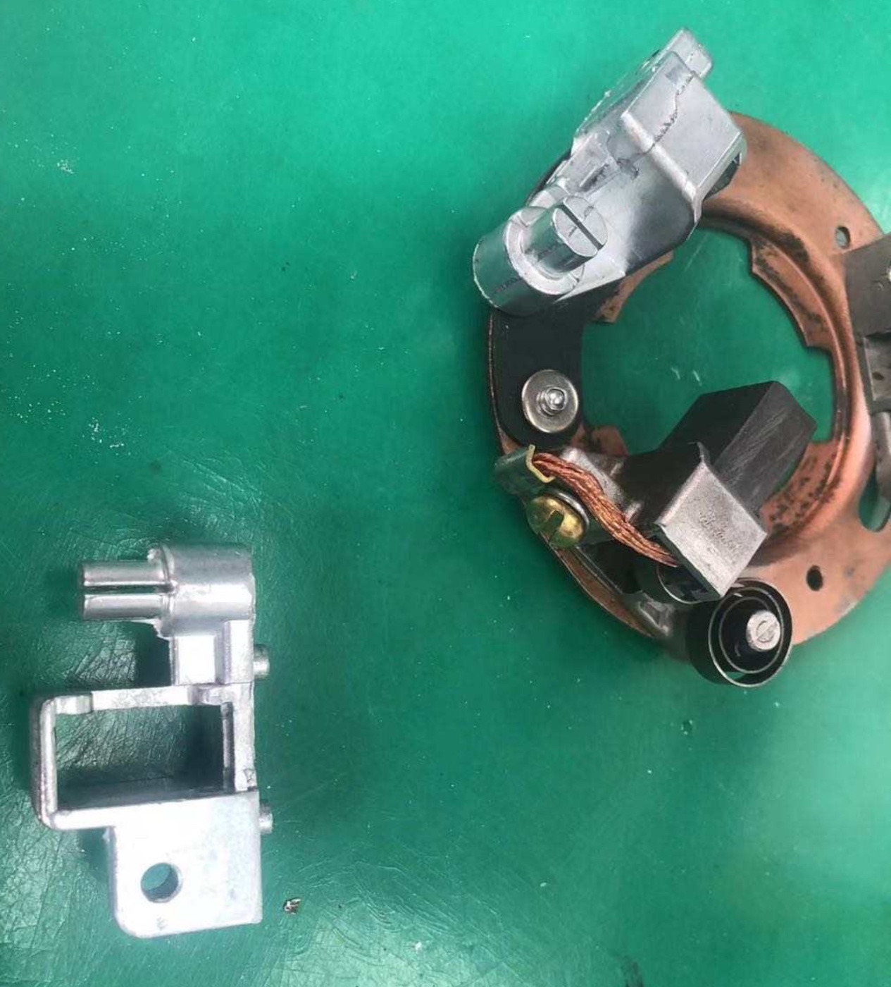

Fitment As with most projects like this, it is time consuming, rarely works the first time, and the smallest details matter A LOT! Hopefully rev 2 will make the cut.
. 3D renderings .
