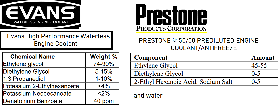

Price is in the ingredients
RVA23T
- Posts: 849
- Last Name: C
Re: Evans waterless coolant
Looks like mostly undiluted regular old antifreeze!
