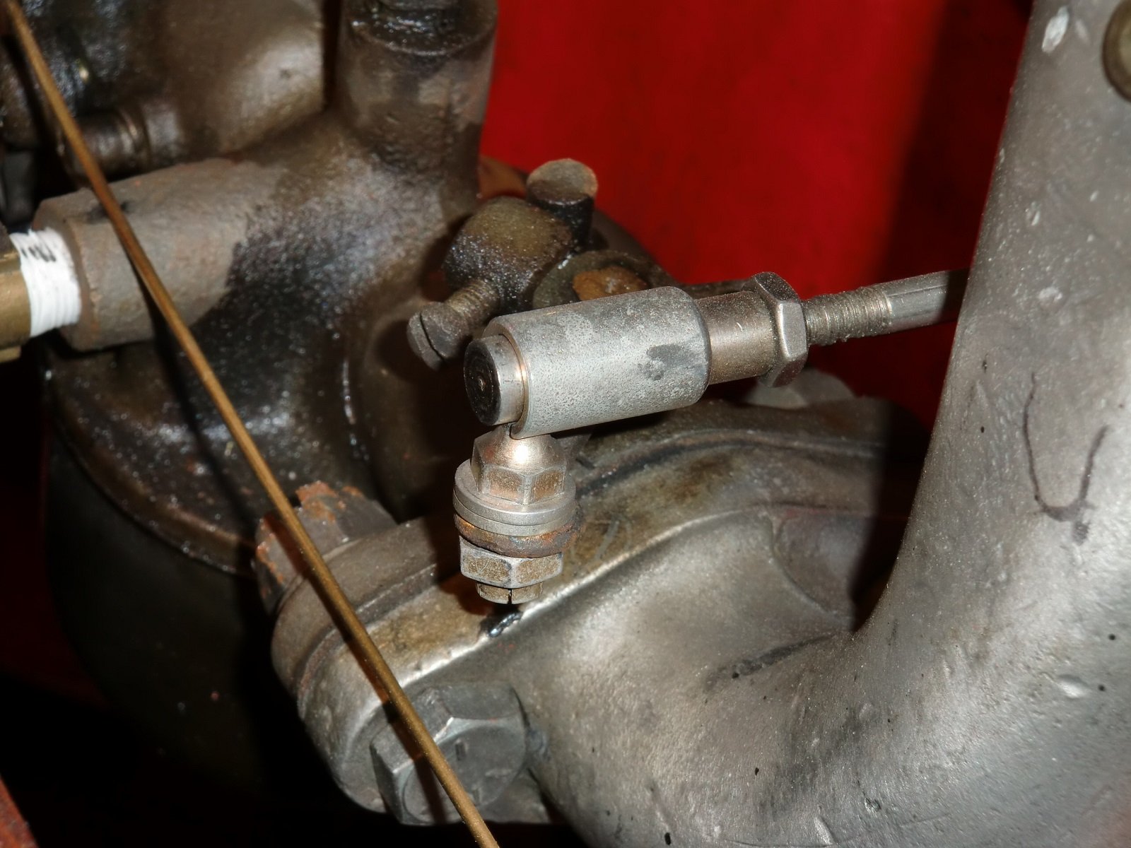

I put "Rod Ends" on my timer and throttle.
I don't have any play in either one now.

These are non-stock additions I made to my '16 T.
