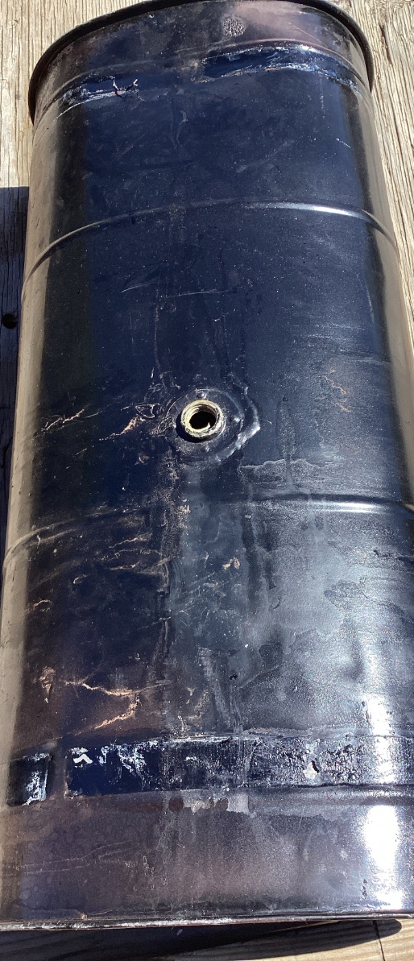

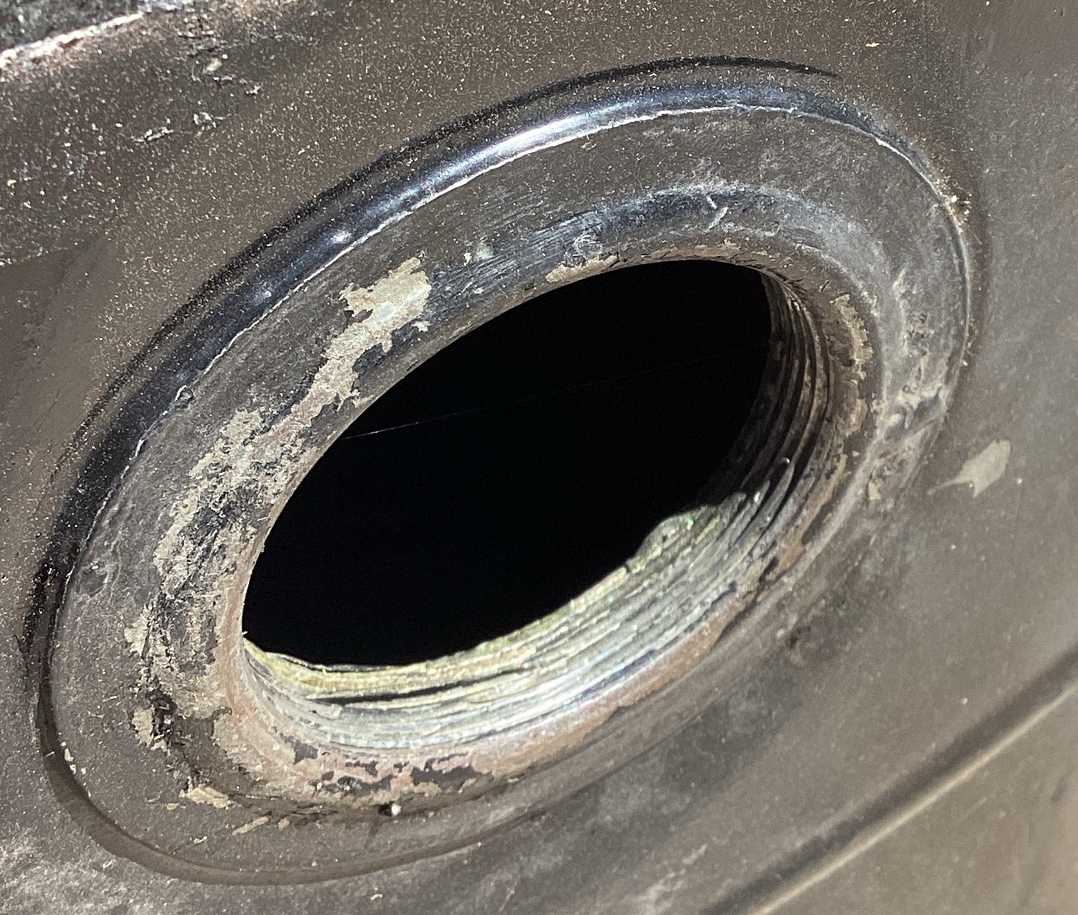

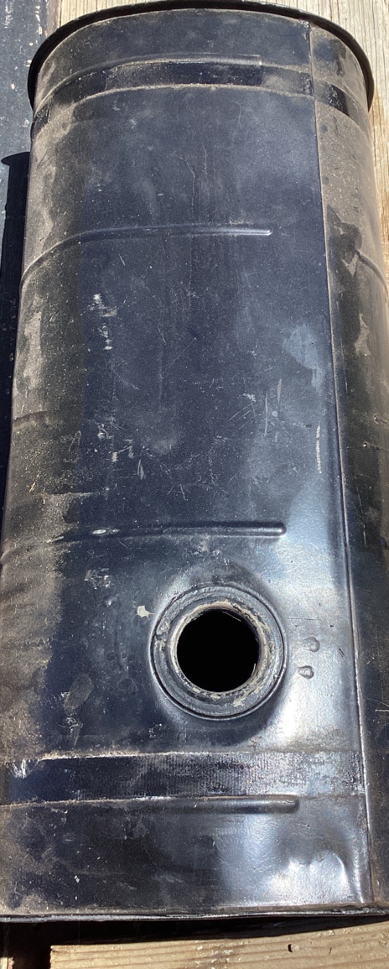

I coated my gas tank with the proper liquid liner five years ago. Followed the directions and even waited longer than necessary for proper cure of the gas tank liner. Always had gas flow problems and now I finally figured out why. ( I am slow ) The liner is coming out in sheets from the sediment bowl, which is clogging up the fuel line. I ordered a new gas tank, but what do I do with the old tank safely. I don’t want to blow up the trash truck.

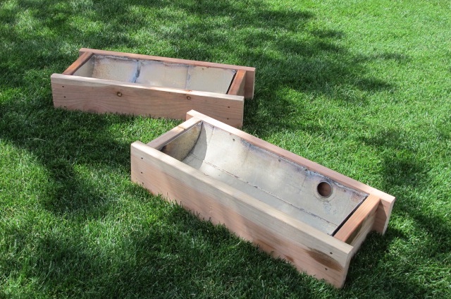

If it's beyond repair, make a planter out of it... or a waste basket.
