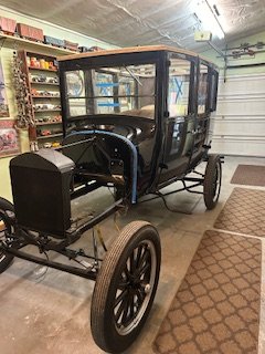

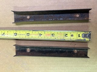

I took these two parts off of the rear windows and I can't remember where they go. One for each side? Car is coming along good. Just painted the body. Still have the fenders and hood to paint. You have to lay down to look at the one picture!!!!!

inside the rear qtr windows for the felt strip guides, the steel doors should have guides in them but rear has wood and they tack in place.

exactly what joe said i just finished a fordor snyder has the right felt door channel also just not like original and you will have to do some shaping

OK. Thanks very much. I put all new channels in so I coverd up the old nail holes. I knew they went there some where.

Well I thought I knew where the parts go but I can't find any old holes for them. Could someone give me a drawing. Thank you

They should go under the rear quarter belt rail where the window assembly goes. The original felt window channel sits in them.
