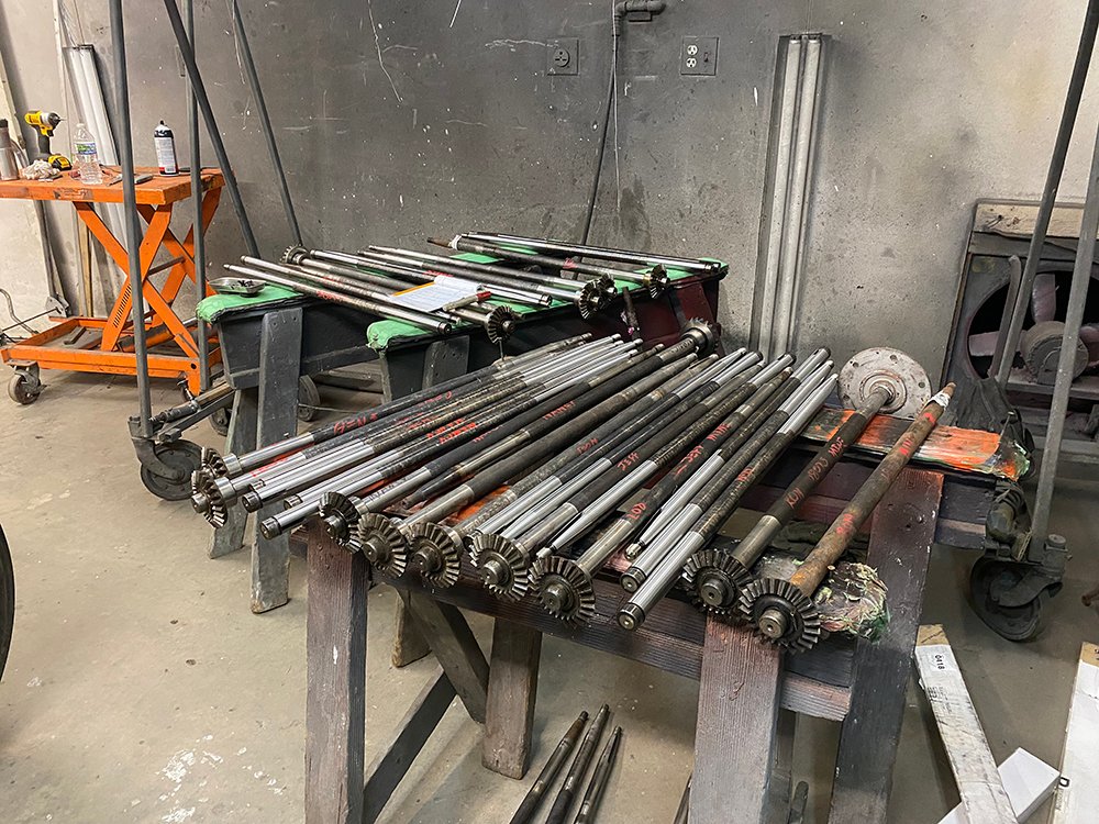

I've attached a photo taken in Denny Newman's shop. Those are all axles being replaced for one thing or another. There are some new ones in the pile but you get the idea.

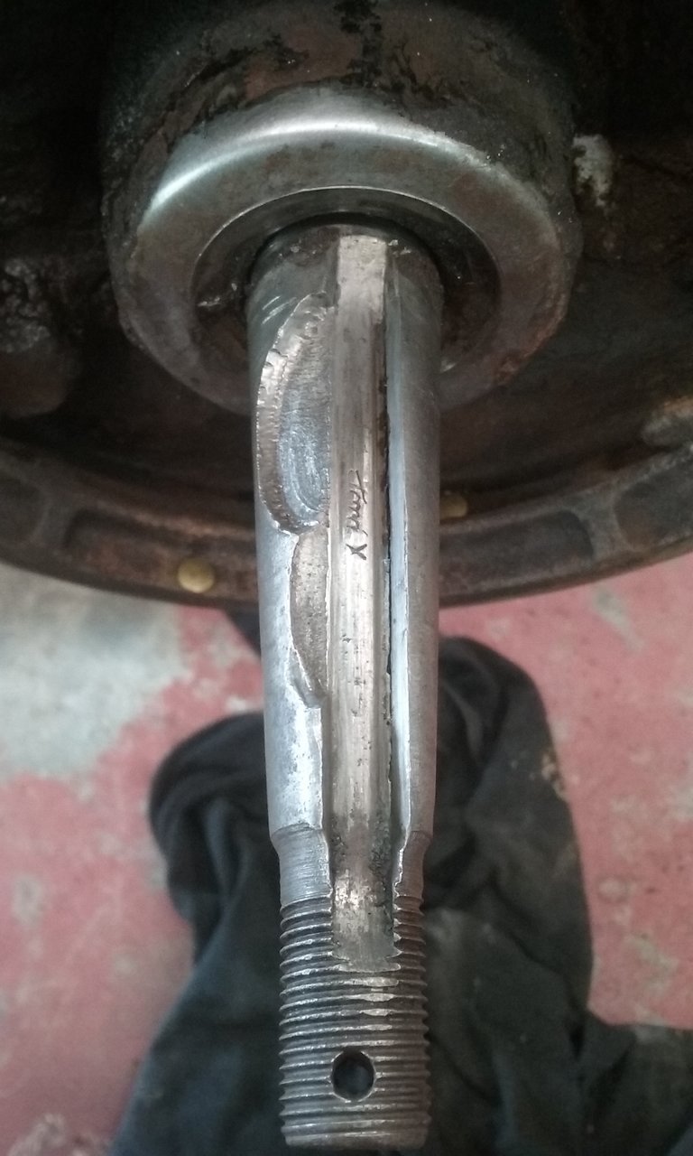

The other photo shows a keyway with some big chunks missing. Fortunately new axles are available for a reasonable cost. The new ones are 1/16th of an inch longer which helps if you go with floating hubs or disc brakes.

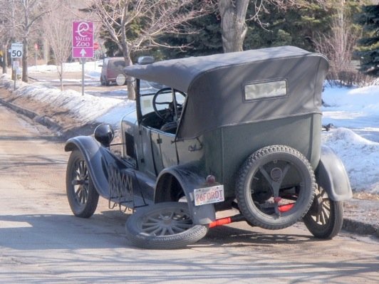

Don't be like the guy in the last photo.

I'm the guy in the last photo!
That was likely an original axle (the 1960s 'Restorer' replaced very few parts), and snapped across the diameter where the original-style felt seal metal retainer would ride.
I had replaced the failed babbitt thrust washer some years earlier but reused the original axle shafts. Both shafts were replaced with new ones following this incident.

Chris, sorry for not checking with you first. The photo popped up on a google image search. One of the guys in our club forgot to install a cotter pin in one of his wheel nuts. After a short drive the nut loosened and the wheel fell off...on a busy street of course. Nobody thought to get a photo - they were too busy dodging cars.
