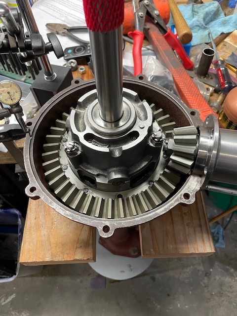

I am building the rear end for my 26 speedster and i am measuring the gear lash. All the gears are new as are the thrust bushings and the axles. I am using a modern drive shaft spindle setup with the roller thrust and shims. The ring gear is torqued down, no burrs on the differential housing. I have been using the club book on building the rear end. I set the lash to .012 but when I rotate the ring gear I get some variation in lash, with about .0085-009 being the tightest but also .01 and .011. Should I use a smaller shim behind the drive shaft gear to get a little more clearance or is this good enough?

Re: Ring gear clearance question
Consider adding one spool gasket 2583G with aviation Permatex. You'll be glad you did.
You always have variation in lash. Yours is better than most but a bit more clearance wouldnt hurt. T rear ends run best with about .015" lash imho.

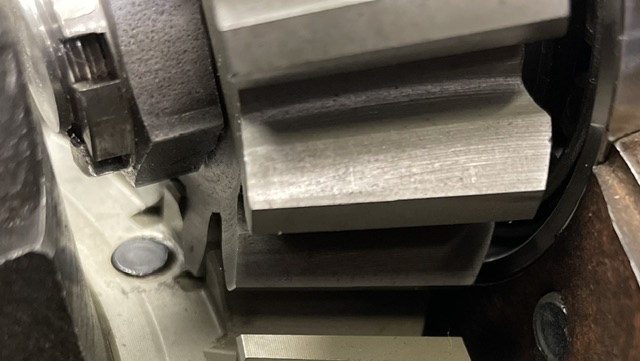

Morgan, it looks like you not have the pinion gear meshing for the entire width of the teeth with the ring gear. This should be the first step. Then mess with the backlash if needed. That may well be how it was done in the hurly- burly of the production line, but it is not the best way to do it. Backlash is not the whole answer. With the correct rolling fit with the gear teeth, the backlash is then what it is.
Thanks Allan,
Here is a better shot of the gear alignment. It looks pretty good to me and If I run the pinion in farther the lash decreases to between .003 and .005, which is too tight. Once I get a decent lash, I will use some Prussian blue to check gear engagement to be sure I am gettin engagement across the ring gear.
The steel and bronze thrust washers are within speck, but if needed, I could take some off of the bronze washer. I need to do it on the right one anyway.
As with many things on the T, there is a lot of fiddling to get things right.
Move the pinion in and out until you get a good tooth bearing pattern. You do not want the contact at the toe of the teeth- more to the heel should be your goal. Then move the ring gear in and out to adjust the backlash. You do not want less than about .010 backlash. From your picture my guess is your pinion is too deep, causing the bearing on the toe that you are seeing.
That's a better angle Morgan. You do have room to withdraw the pinion a little. Setting backlash as the way to go is not necessarily the best way to achieve the best gear mesh. Once the depth of mesh is done, the correct mesh across the gear teeth is achieved by moving the ring gear. This means you have to move the diff centre within the housing. This is done by shuffling steel discs and bronze washers from one side to the other.
If your blue shows contact at the outer end of the ring gear teeth, you have too much backlash, so the ring gear needs to be moved towards the pinion.
Contact on the inner end means too little backlash and the ring gear needs to be moved away.
Once you have the gears engaged across the whole face of the teeth, the blue will show this. If that contact is right at the toe of the teeth, then you move the pinion back towards the ring gear. If it is at the bottom of the ring gear teeth, the pinion needs to be moved forward. The best result is when the contact is almost full face on the teeth.
When I build a rear axle assembly, I go through my collection of steel discs to find four with the maximunm variation in thickness. Likewise when tackling the bronze thrust washers, I like to have one some .010 - .012" thicker than the other. That way you can just juggle that 6 piece stack until you get the ring gear in the best place.
It is interesting then to measure the backlash you end up with. The backlash you have is the backlash needed for the best mesh of that set of gears.
All this is detailed in Tinkerin Tips 2.

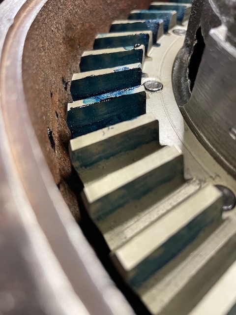

With a little adjustment this is what I have. Looks pretty even and centered, though it’s a bit hard to see. I still am getting some variation in lash on different quadrants of the ring gear (about .003 high to low). I have about .012 lash at the max, and about .009 at the min. I am going to thin down a bronze thrust washer a few thousandths and see if I can increase the lash.
Run a small piece of copy paper through & check the pattern.
- Posts: 5128
You should see an even fold across the tooth. The fold should be sharp but not cut the paper or bind the movement.
Contact with the bluing looks good. Spin the drive shaft. You should not feel any dragging spots.
A note of caution. Your drive shaft must be perfectly supported in a neutral position. If not, your actual lash will be off.
I like installing a radius rod to be sure.
By fiddling with the spacers I was able to get between .011 and .015 lash. It spins freely all the way around. When I ran a strip of paper through the gears it didn’t bind up, though it took out all the lash. I don’t want to open it up too much more. Next step is to get the spacing sorted between the axle housings.
That looks very good. Variation in lash is normal. Don't be concerned by it unless there is actual binding.Reno Speedster wrote: ↑Mon May 27, 2024 1:58 pmWith a little adjustment this is what I have. Looks pretty even and centered, though it’s a bit hard to see. I still am getting some variation in lash on different quadrants of the ring gear (about .003 high to low). I have about .012 lash at the max, and about .009 at the min. I am going to thin down a bronze thrust washer a few thousandths and see if I can increase the lash.
