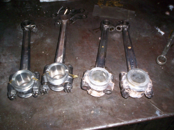

Ford had a few teething issues when he released the first of the T's, water pump being the one every one remembers but along with that was X'd and dipper big ends, done away with that idea as well, today's oils are far better but it has still been proven over the years that
x'ing has a shorter milage to that of a correct swipe line bearing. X'ing such a small surface area as the T big end will relieve internal pressure, not enhance it. I do only T rebuilds, babbit and all, never had a rod fail and some drive their T's hard, I do fit dippers.

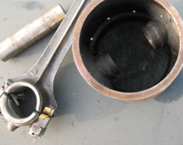

After the 08/9 fail, Ford did try it again in 1927, once again a very short life, the rods didn't even make it to the spare parts books.

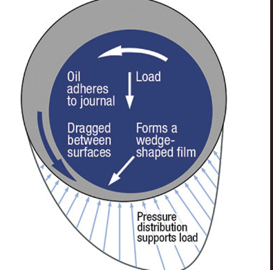

I am willing to comprise on Xing the connecting rod babbitt and to follow the theory of hydrodynamic lubrication (HDL).
The compromise is:
X on the rod cap
No X on the rod
As I recall from 60 years ago, the theory of HDL involves a 7th order differential equation.
Art Mirtes
