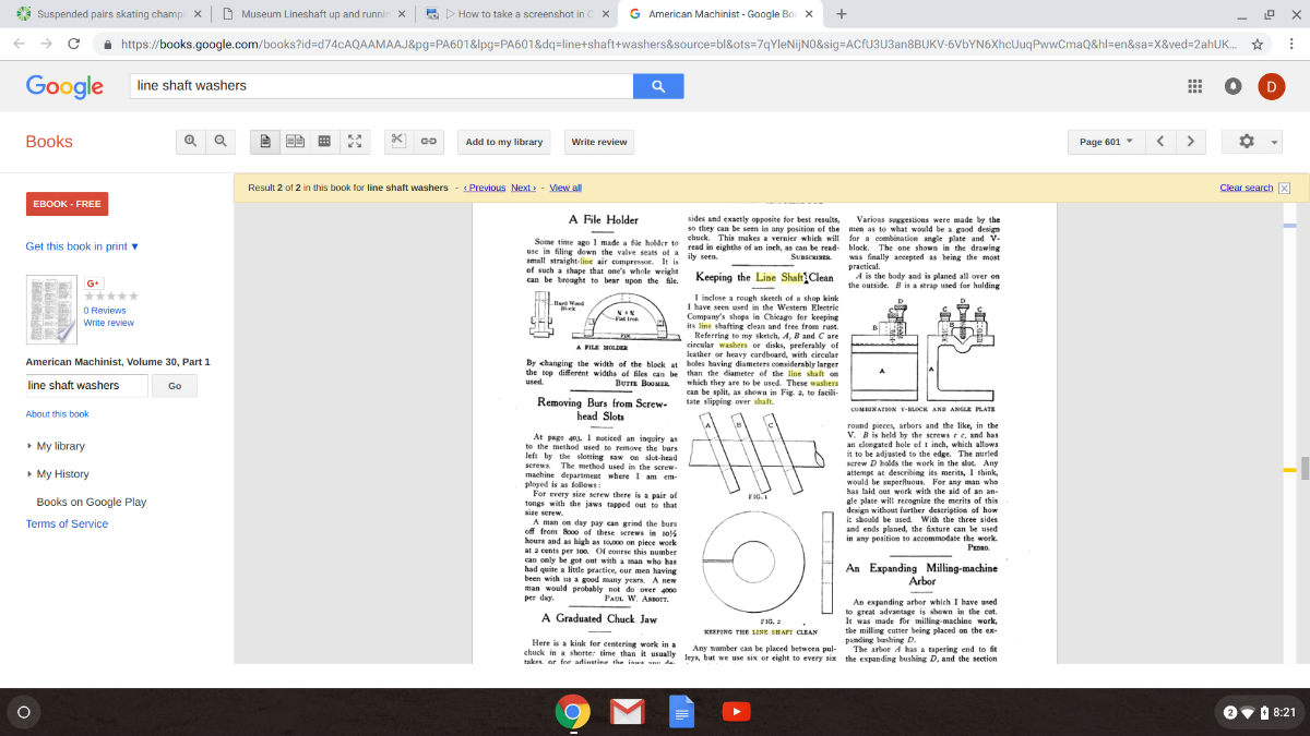

I don't see any washers on the shaft.

We didn’t think about the washers that move back and forth to keep the line shaft clean until after the shafts were installed. Hopefully someone will come up with a way to add them without disassembling the shafts.

I did not know about washers on a line shaft until I went to the OCF in 2016, someone asked about them and their function. When the person in the machine shop explained their function it made sense to not have a lot of oil flying off the shaft. Should be easy enough to add them, couple of cardboard circles with a split then glued together. Thanks for posting the video.

Dan and Mark, Both great ideas. We may experiment using material other than steel. I did add grease zerks to all the bearings to minimize drips and frequency of lubrications. Thanks for your thoughts.

Dan, Thanks for the info. We will definitely try the cardboard rings.,
