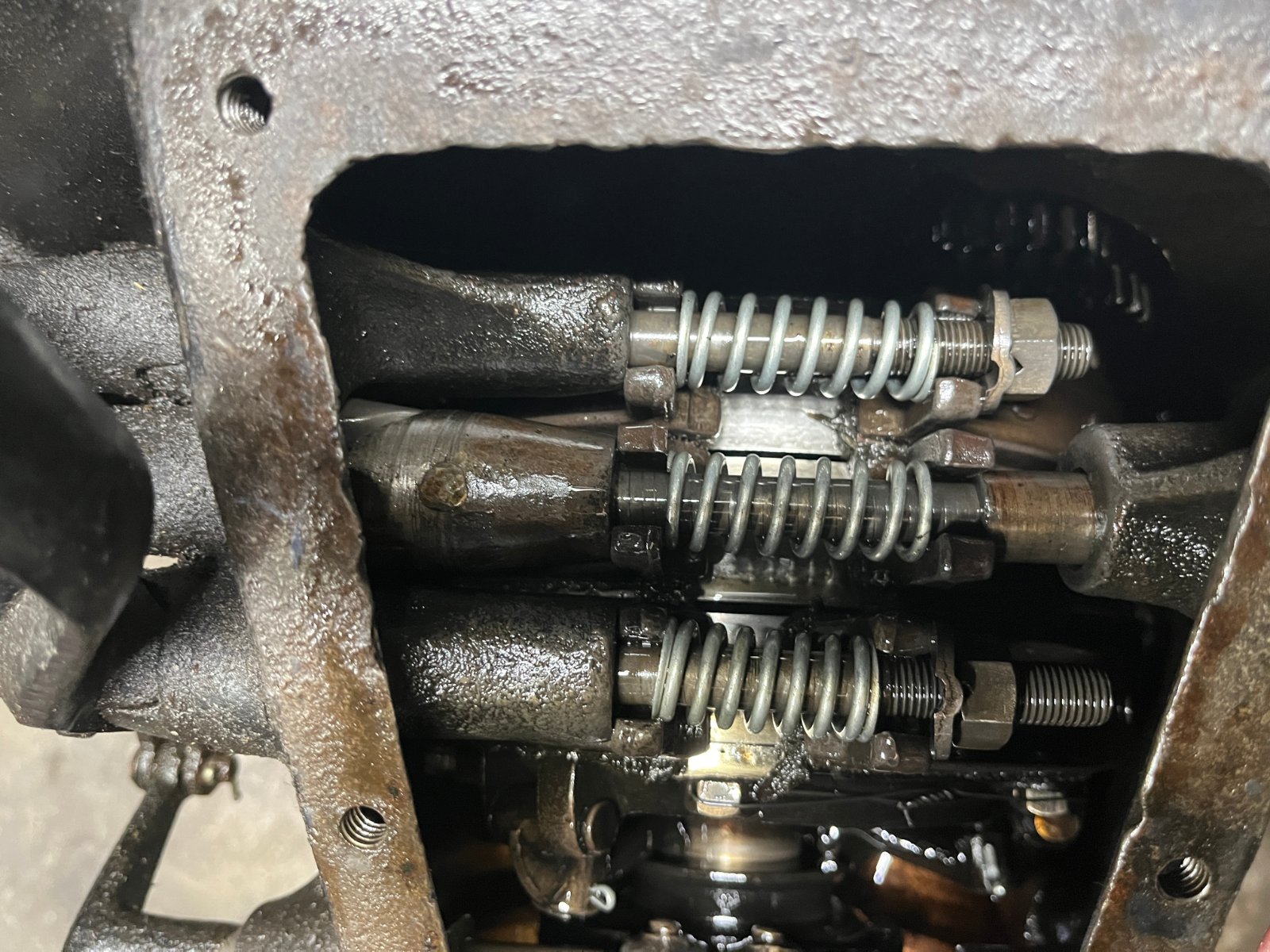

I drove my '19 around town last Saturday and gradually the foot brake became less and less effective. By the time I pulled in the garage, the pedal would go to the floor with basically no braking. Because it worked well at the start of the 10 mile drive, I was expecting a big oily fuzzball inside the trans, but that's not what I found. The brake band is adjusted tighter than low and reverse, but the lining is still there. This being my first band issue, anyone care to assess what I have?
I think I am in the market for re-lined quick change bands, if anyone has a set for sale.

Re: Transmission Bands - When to Replace?
Go for a new set of relined bands and new band springs

How's your drum look? If it is a bluish color it is caused by the shoe dragging on the drum and can also lead to a cracked drum. You need good springs and the slots in the floor board and mat should not cause the pedal to stick.

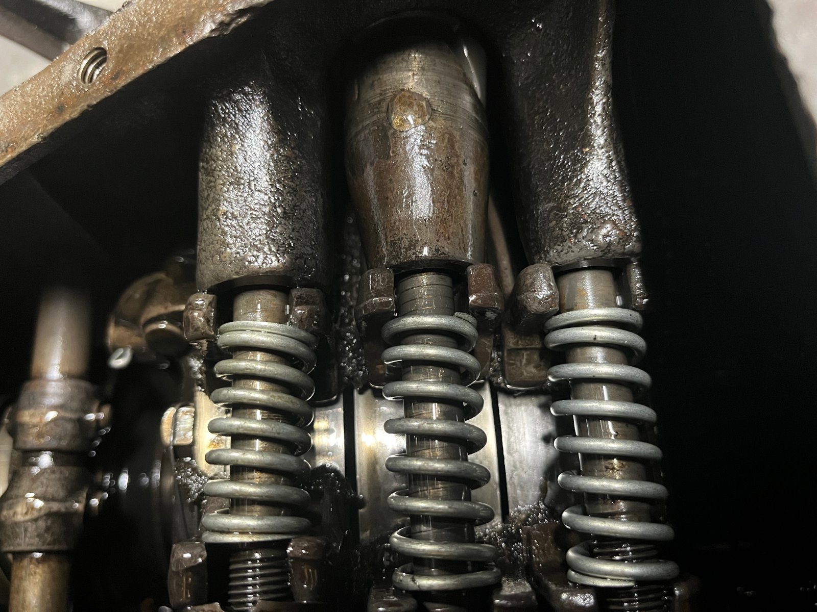

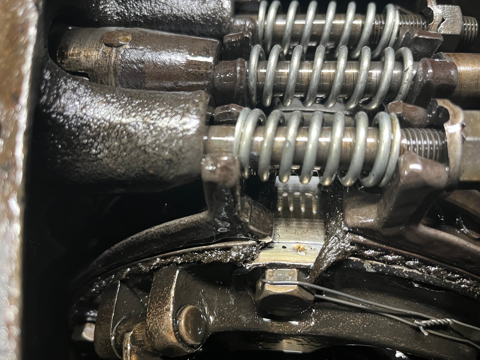

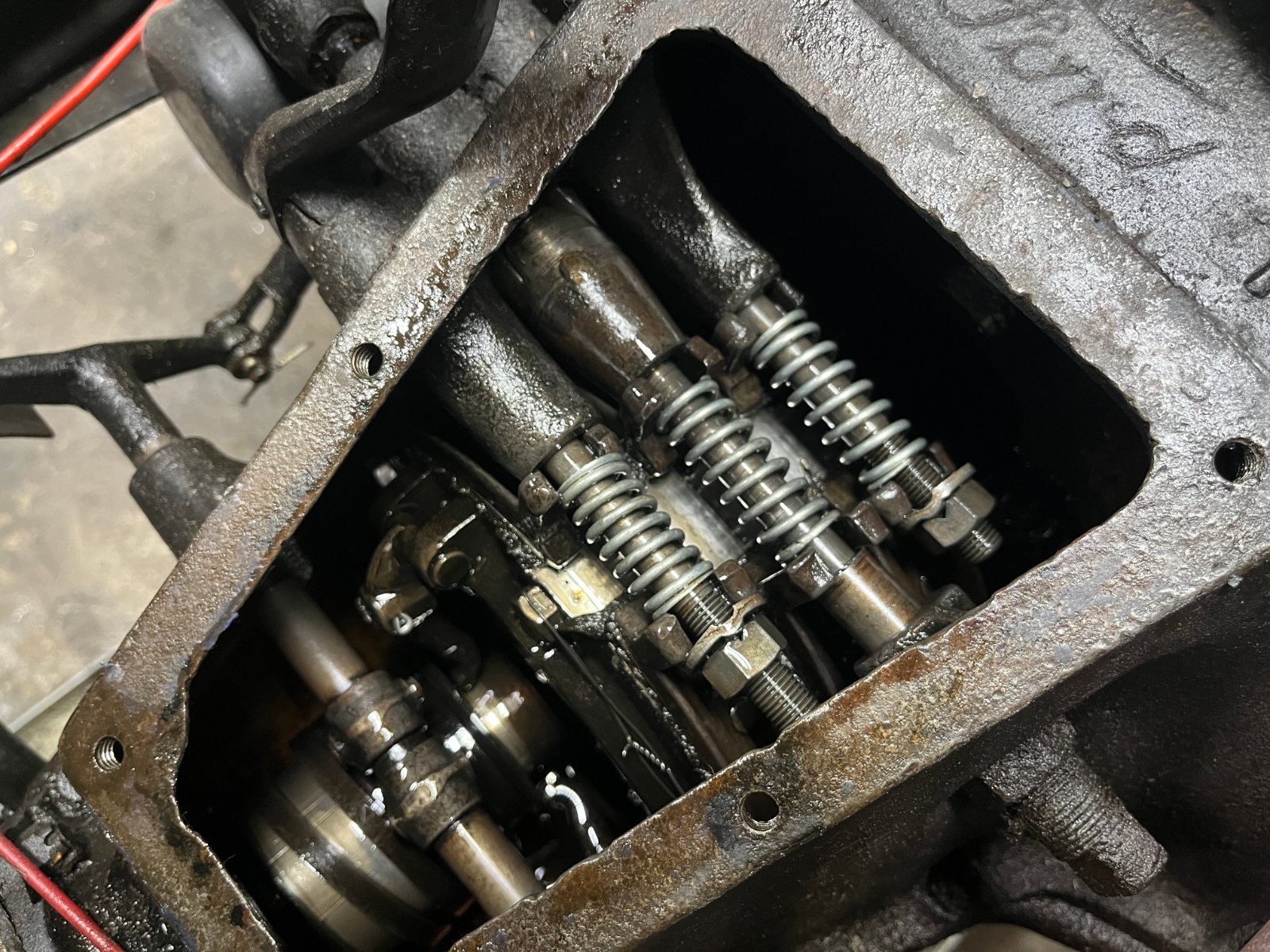

I have a screen. Drums appear smooth and uncracked. No bluing. I assume the brake band sees the most wear, so maybe the fact that it's tighter than the other two is normal. I understand that this is a "how heavy is a rock" type question, but does the brake band look to be at the end of it's life? Finally, where can I buy bands ready to install?

Judging the spring & thin side on the left, yes, replace.
Cotton/Scandia band material will rot over time. They look mushy.
I would replace them all. (but that me. I take a proactive approach) The other bands appear to be unraveling a bit.

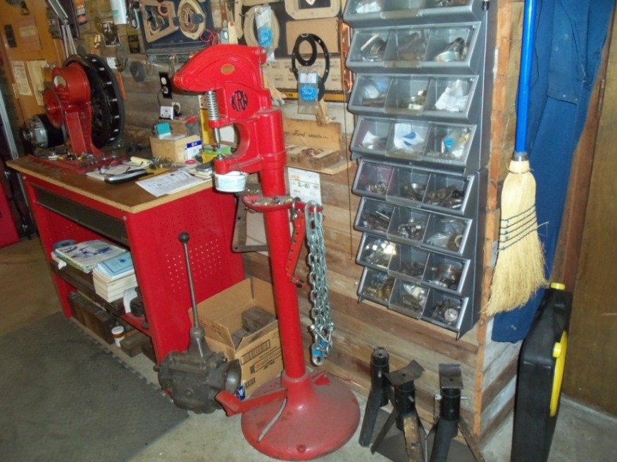

This machine makes lining bands way easier !!!
