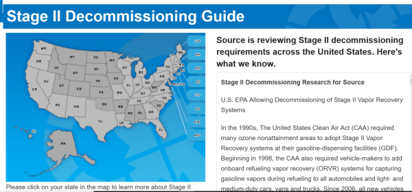

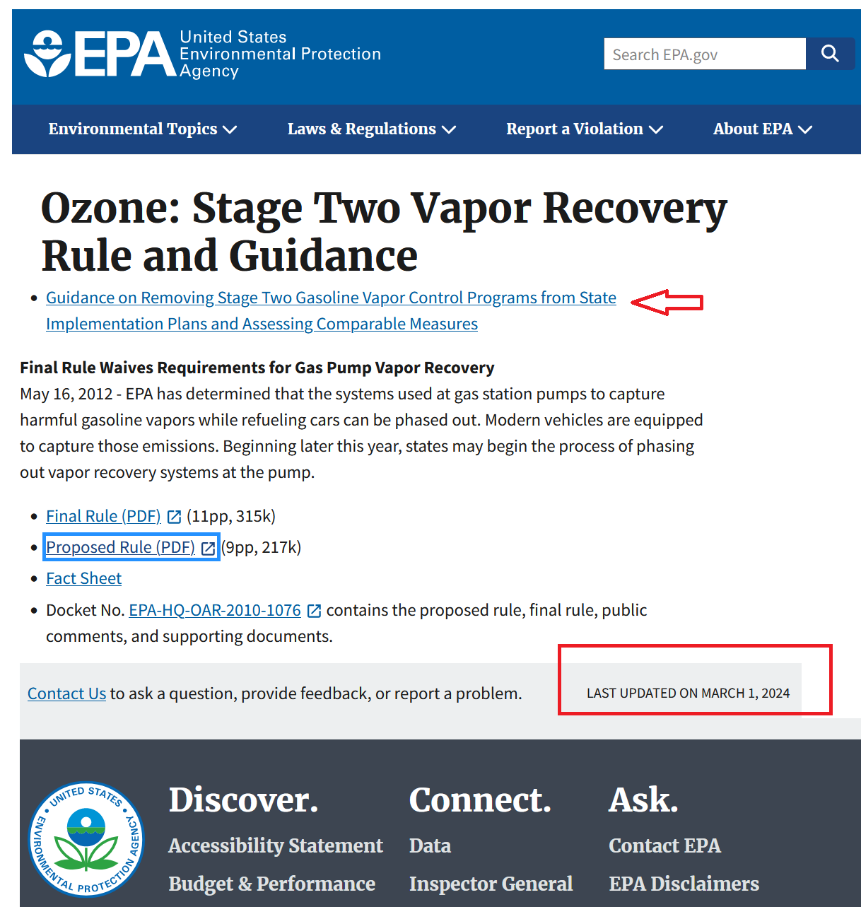

Looks like many States that had them can now remove them. However, some Local Cities & Counties may still require them.
EPA Info site https://www.epa.gov/ground-level-ozone- ... d-guidance
If you go to this site it will explain what the State plans are by clicking on the state in the map on the site https://www.sourcena.com/stage2/
