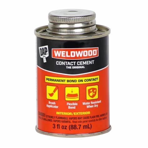

jiminbartow
Posts: 2481
Last Name: Patrick
Location: Bartow, FL
Re: Is There A Fix For This Inner Tube?
Post by jiminbartow » Wed Jun 12, 2024 3:46 pm
How about Weldwood contact adhesive on a rubber patch and tube scuffed up with 80 grit sandpaper. I’ll bet that would hold.
