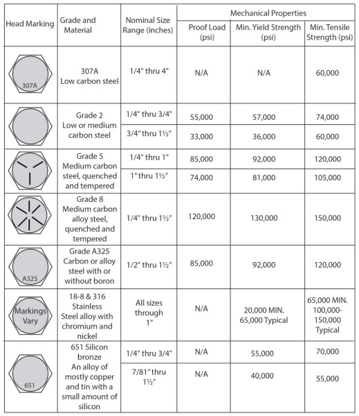

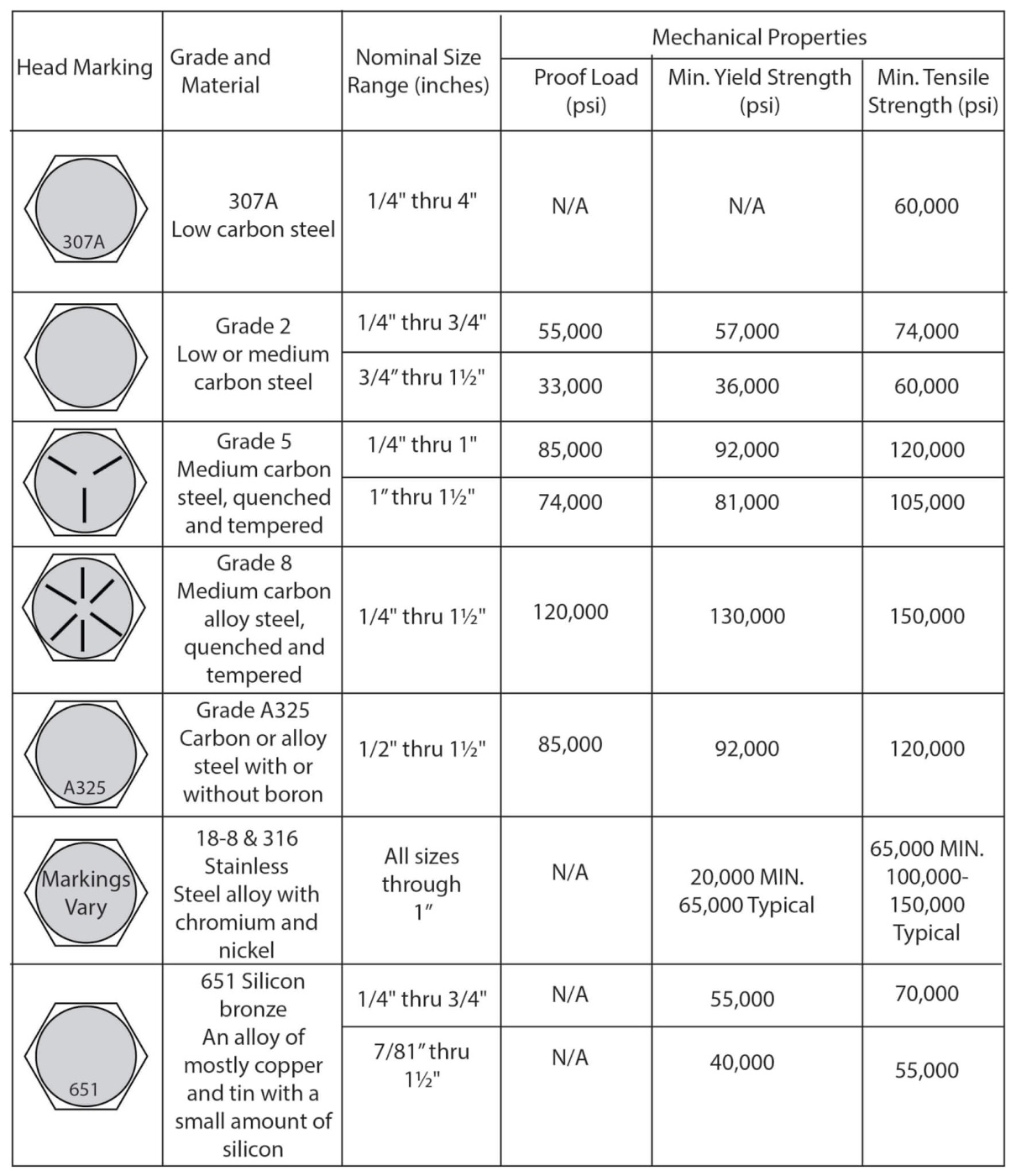

Regular bolts are grade 2. Grade 5 is a very strong bolt. The only stronger grade is grade 8. Grade 5 is more than strong enough for this application.
