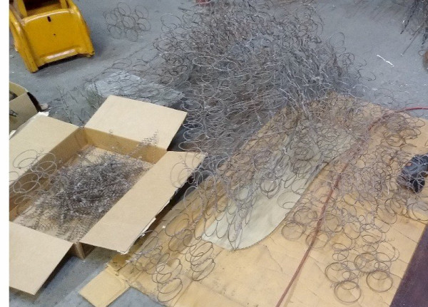

I did a search (MTFCA mattress) and have not seen where anyone made seats from mattress springs...then burlap, cotton, covering, hog rings...
Anyone ever done that?
I used a spring or two from a mattress maybe two years ago to fix my existing seats and they seem to be the exact shape and size.

If I dump out the plastic bag mine are stored in, they would come out in a clump like that photo! :lol:
