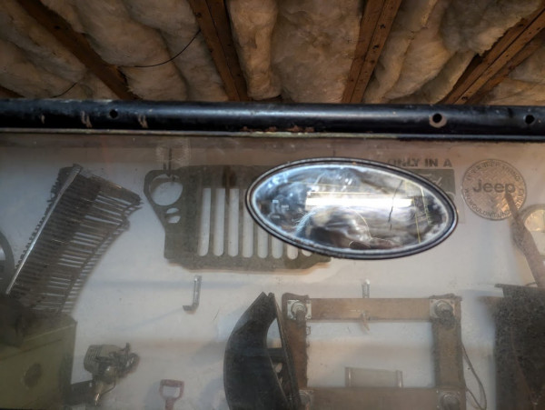

My 25 touring has three holes drilled in the top of the windshield frame. None of them looks like anything was ever bolted through them. Were they there for a windshield wiper and or mirror? When were windshield wipers introduced, and/or standardized? My car has a mirror drilled through the glass. How common was that?

First mirror mounted into the glass I have seen.

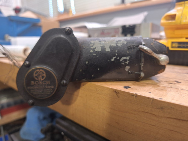

Yet another possibility. Bosch made a 6volt wiper for the Ts.

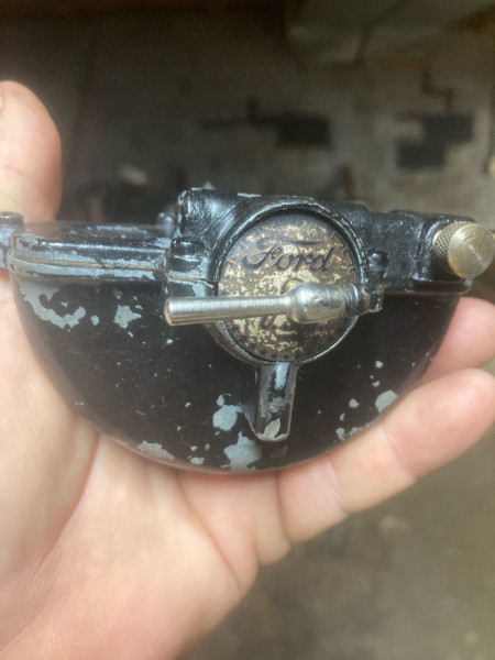

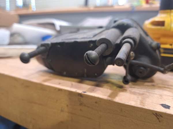

Original Ford 1926/27. I’m guessing this was a Dealer item? I’d love to get it restored and put on my 27 Roadster.
