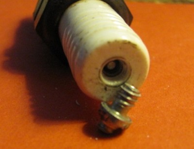

Broken center electrode from pliers used to tighten the plug wire
Champion 25 uses an adhesive fixed upper for the center electrode.
Best to always tighten spark wires with only finger and thumb, holding the plug thumb nut as you rotate the wire terminal snug.

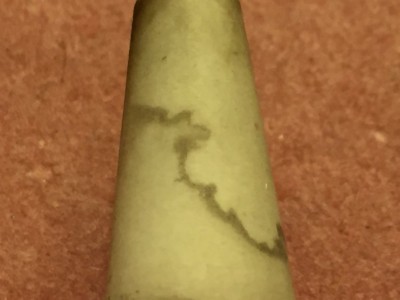

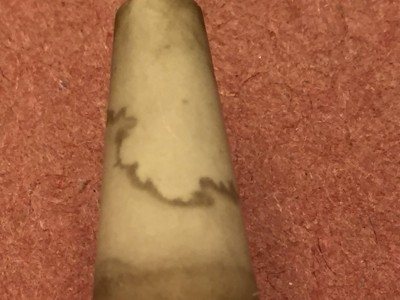

Re: Why spark plugs fail?
I had an annoying skip while under load that drove me crazy for weeks. After checking all the usual suspects, wiring, timing, etc.., i decided to pull all the plugs apart and found this. Although i couldn't visually detect a crack in the porcelain, there was some definite carbon tracking going on. Replaced the plug with a spare i had, and the skip was gone. You never know how little things like this can make your T run, but then again, that's part of the fun of this hobby.
