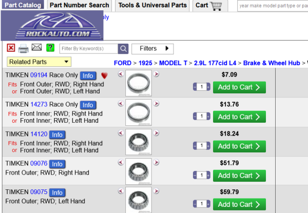

Wheel bearing grease, numerous manufacturers. If you need new bearings or races, Rock Auto has the best prices.
(Thank you Frank Brandi)
Thank You.
