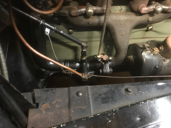

Moxie26
Posts: 2037
Last Name: Jablonski
Location: New Jersey
Re: Vaporizer or NH
Post by Moxie26 » Mon Jul 22, 2024 1:19 pm
Linkage on the '26

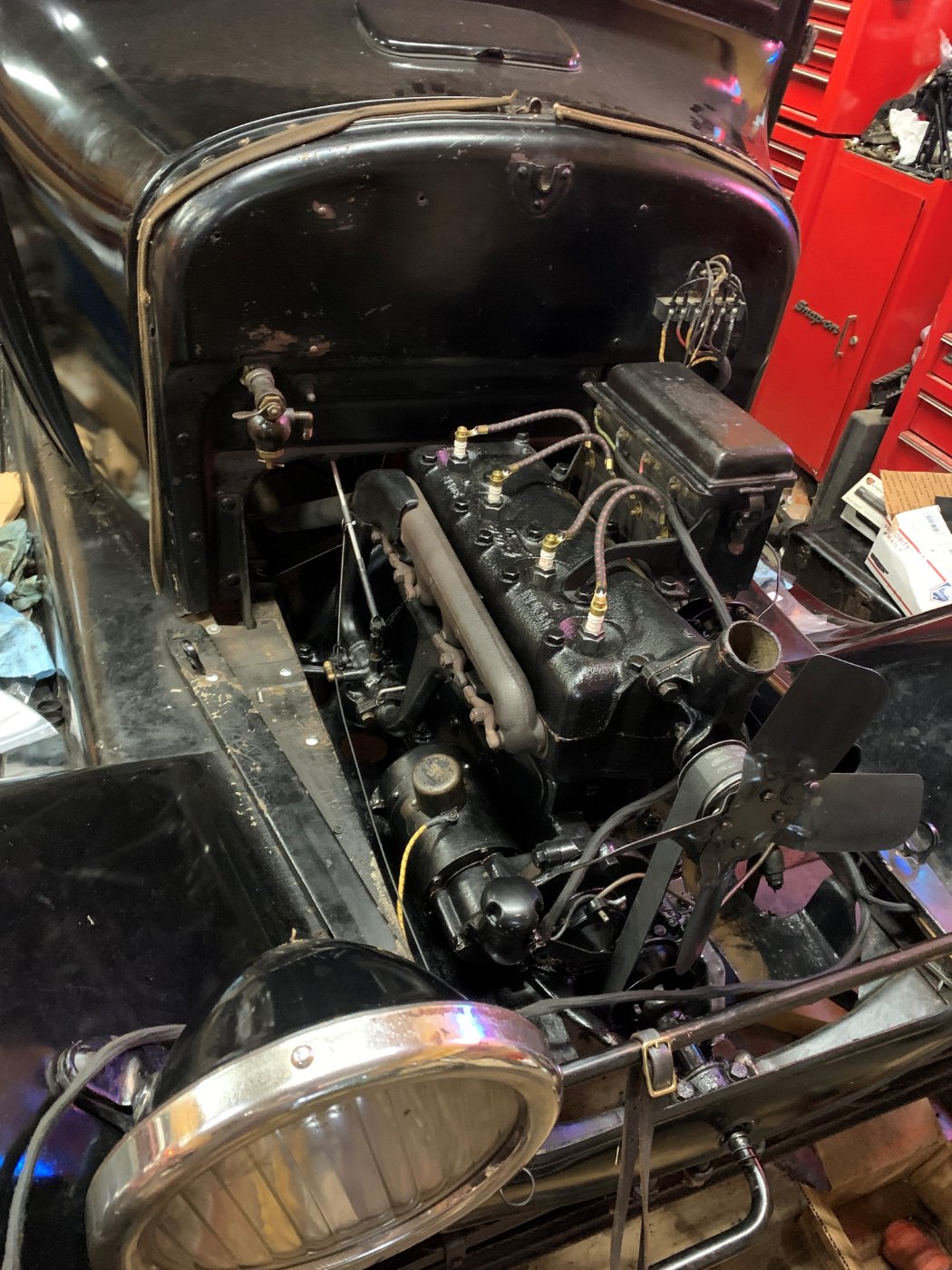

Russ T Fender
Posts: 471
First Name: Val
Last Name: Soupios
Location: Jupiter Florida
Re: Vaporizer or NH
Post by Russ T Fender » Mon Jul 22, 2024 5:16 pm
Here is my set up

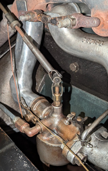

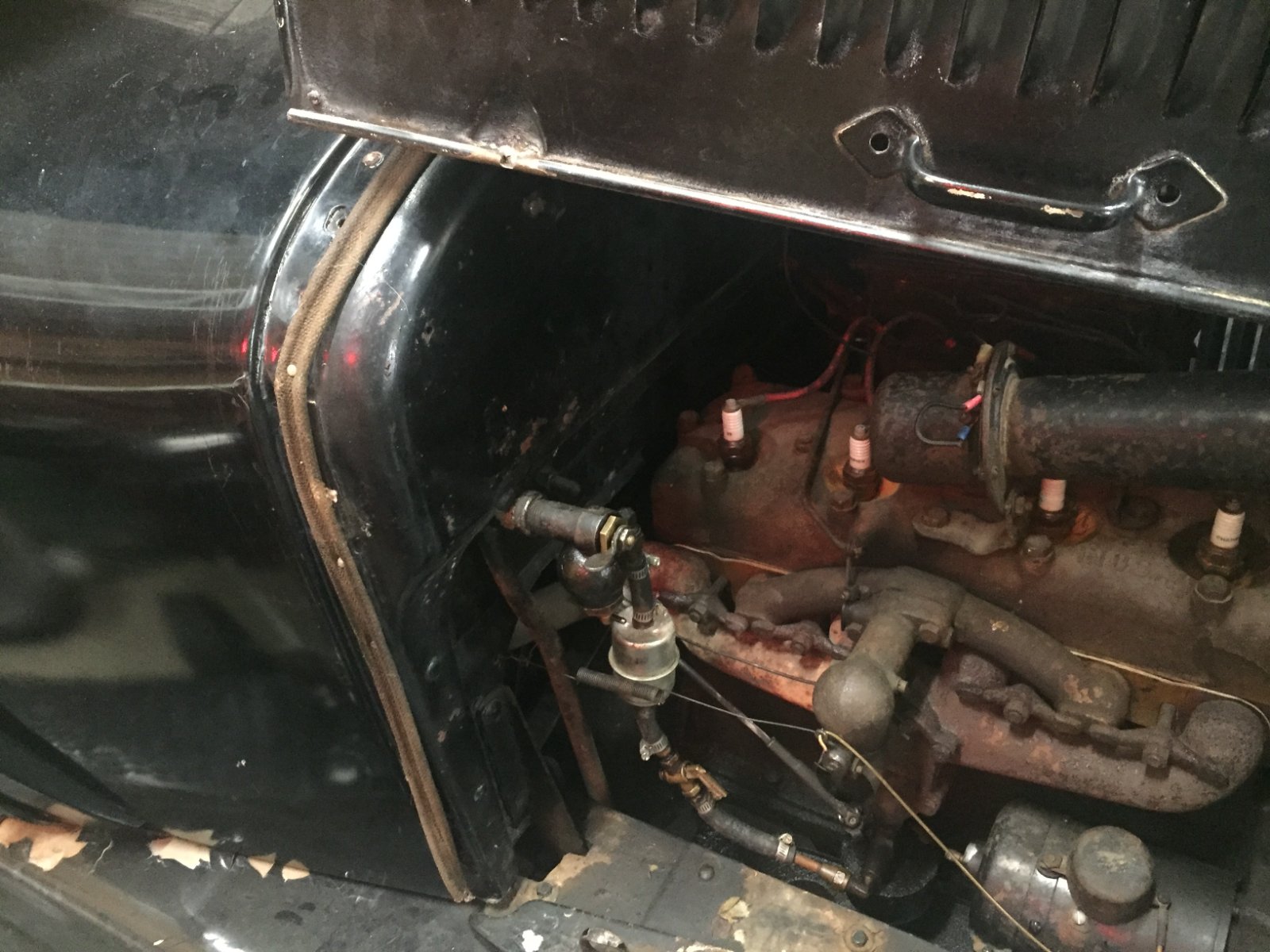

Scott C.
Posts: 856
Last Name: Clements
Location: Waynetown Indiana
Re: Vaporizer or NH
Post by Scott C. » Tue Jul 23, 2024 12:44 pm
You will need a shorter fuel control/choke rod. The one that runs up through the dash. Here are pictures of with vaporizer and then with an NH.
Dave Young
Posts: 240
Joined: Sun Feb 24, 2019 9:37 pm
First Name: David
Last Name: Young
* REQUIRED* Type and Year of Model Ts owned: 26 Touring, 26 RPU, 24 Coupe, 26 Speedster, 28 Chandler, 29 Chandler, 29 A
Location: Mays Landing, Nj
Re: Vaporizer or NH
Post by Dave Young » Wed Jul 24, 2024 9:30 pm
Thanks for the photos!
