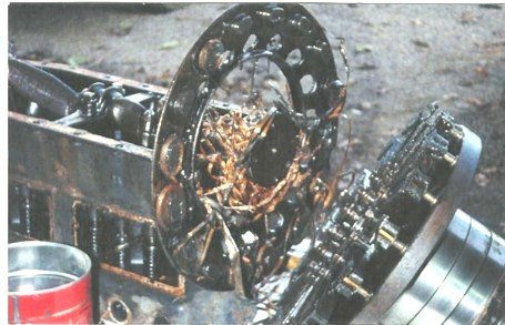

I strongly suggest youfix .042 endplay or your gonna have a problem that could run $5-7 thsound to fix.
See attached.
Failed Magneto.jpg (39.36 KiB) Viewed 1700 times
See attached.
Ron Patterson
It's already running that much and the only bad thing to happen was the loss of a magnet plate!

CW, you should not waste money on a lottery ticket. If you lost a magnet plate with no extra damage, you have already won the lottery!

.042" endplay and only a plate? you are absolutely correct
