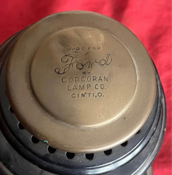

Has anyone found a good way to remove the brass top from a sidelight? I have 2 lights I need to take the tops off to repair the dents. Looks like they have a rolled edge holding them to the top of the light

I’ve destroyed several caps trying to lift the edge to separate them from the steel disk on the underside. I’ve tried annealing the brass prior to lifting the edge, using a razor to try and lift the edge without cracking the brass with not much success. So I looked on line about pulling dents and ending up on Tbay looking at inexpensive paintless dent pullers. Ordered one with extra strong glue sticks & I had moderate success doing that. I had little success at pulling sharp creases,You mileage may very

If there is a void between the brass crown and the steel underneath, you might drill the steel so you can push the dent out with a rod from below. Drill to coincide with the dents. Clamp a rod in a vice. Push the cap against the rod rather than hammer the rod in the cap. It will help to put a small radius on the rod to prevent sharp edges on any brass you push up. Finish with fine wet-n-dry paper and buff to polish. The drilled holes are not seen when the lamp is assembled.
I would not bother with the minor damage in your lamp top.

Back in the day we used to take dents out of off road exhaust pipes by filling the pipe with water and putting it in the freezer overnight. The frozen water would expand and push out the dent.
I wonder if one turned the lamp upside down, drilled a small hole in the underside if there would be enough space for water to fill between the underside and the brass top. If so, maybe freezing it would push the dent out.
