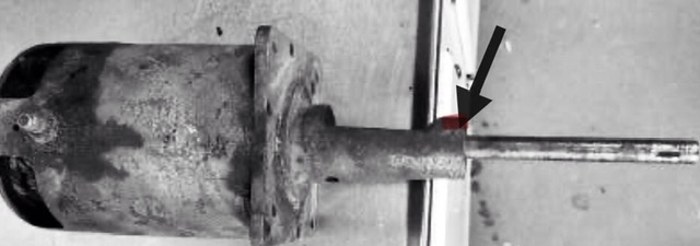

Perhaps a silly reply to the question.
But once removed a starter that had a good portion of the nose (arrow) ground away to satisfy such install.
Photo for illustration only.
