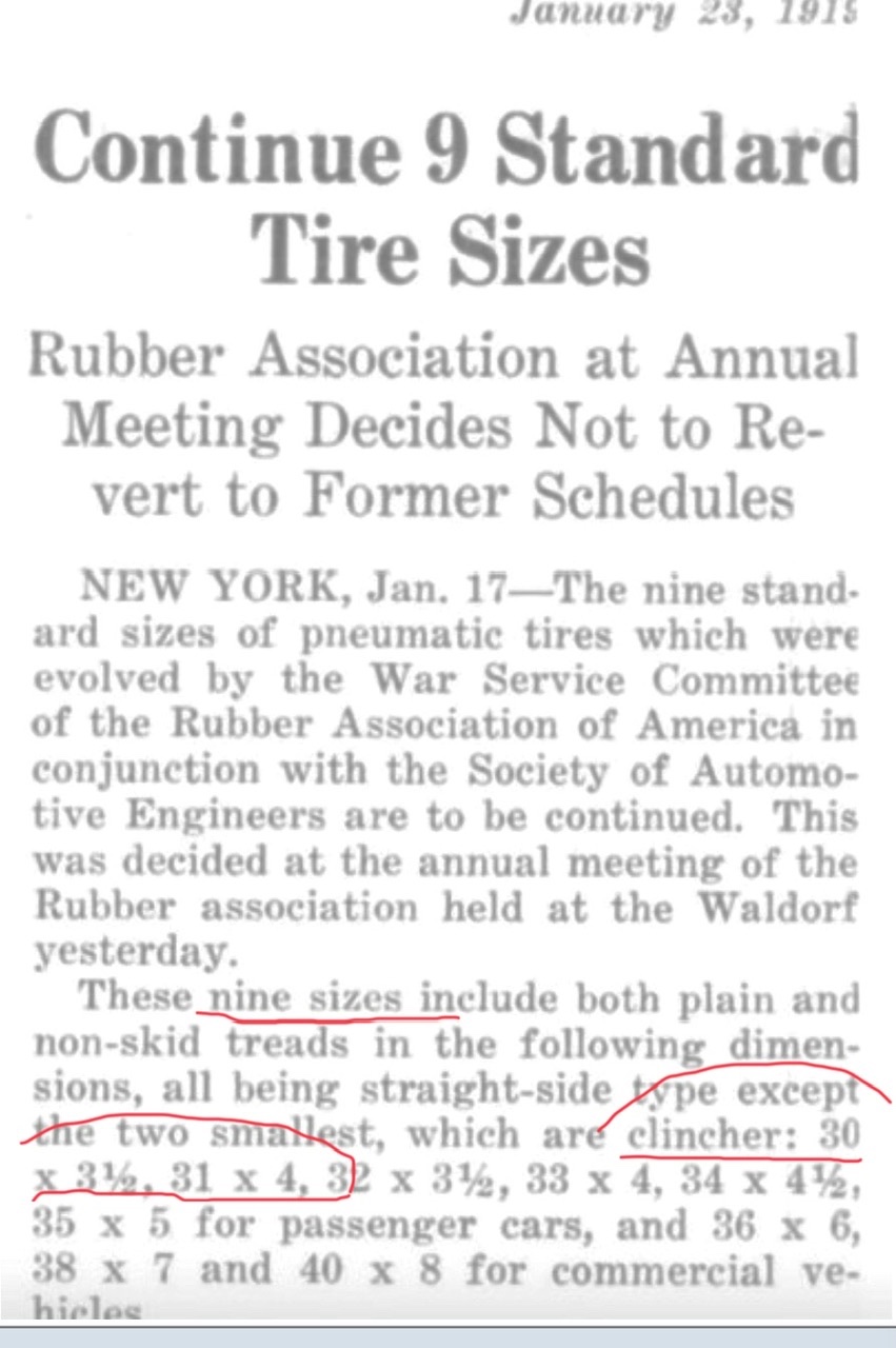

A note about the 30 “ X 3 1/2 “ tire size. Some time after the USA entered WW I in April 1917 the tire size 30” X 3 1/2 “ Oversize became the standard to bridge the 30” and 32” tire sizes with just one tire. This is why the inflated 30 “ X 3 1/2 “ tire ( oversize ) now measures around 31 1/2 inch’s diameter.
- Posts: 4042
Re: Blockley woes

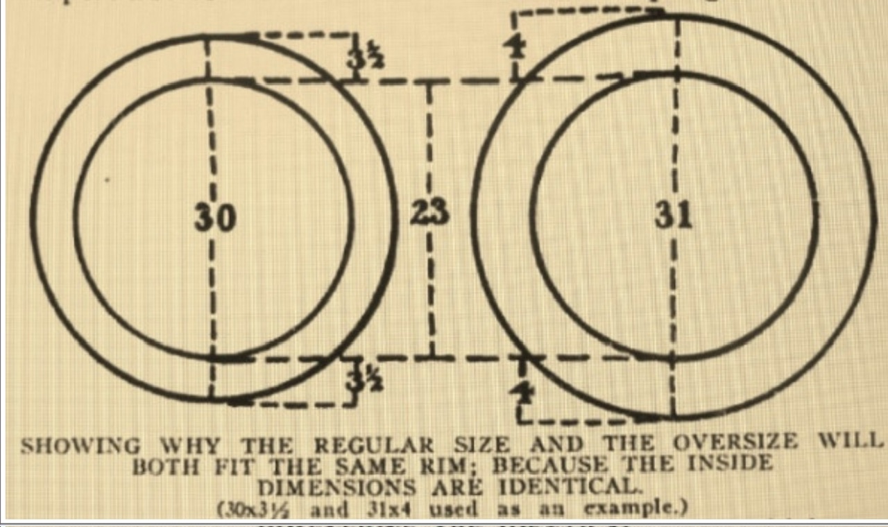

The tire industry consolidated tire sizes and the clincher tires sizes were back then 30x3, 30x31/2 and 31x4.kmatt2 wrote: ↑Fri Jul 26, 2024 7:53 pmA note about the 30 “ X 3 1/2 “ tire size. Some time after the USA entered WW I in April 1917 the tire size 30” X 3 1/2 “ Oversize became the standard to bridge the 30” and 32” tire sizes with just one tire. This is why the inflated 30 “ X 3 1/2 “ tire ( oversize ) now measures around 31 1/2 inch’s diameter.
So as happens tire companies made market for Ford owners in later years to embrace “oversized” clincher tires for more mileage vs cost, the oversized was readily accepted then.
The oversize Ford clinchers today represent that, as they are really 31x4, and fit the 23” rim.

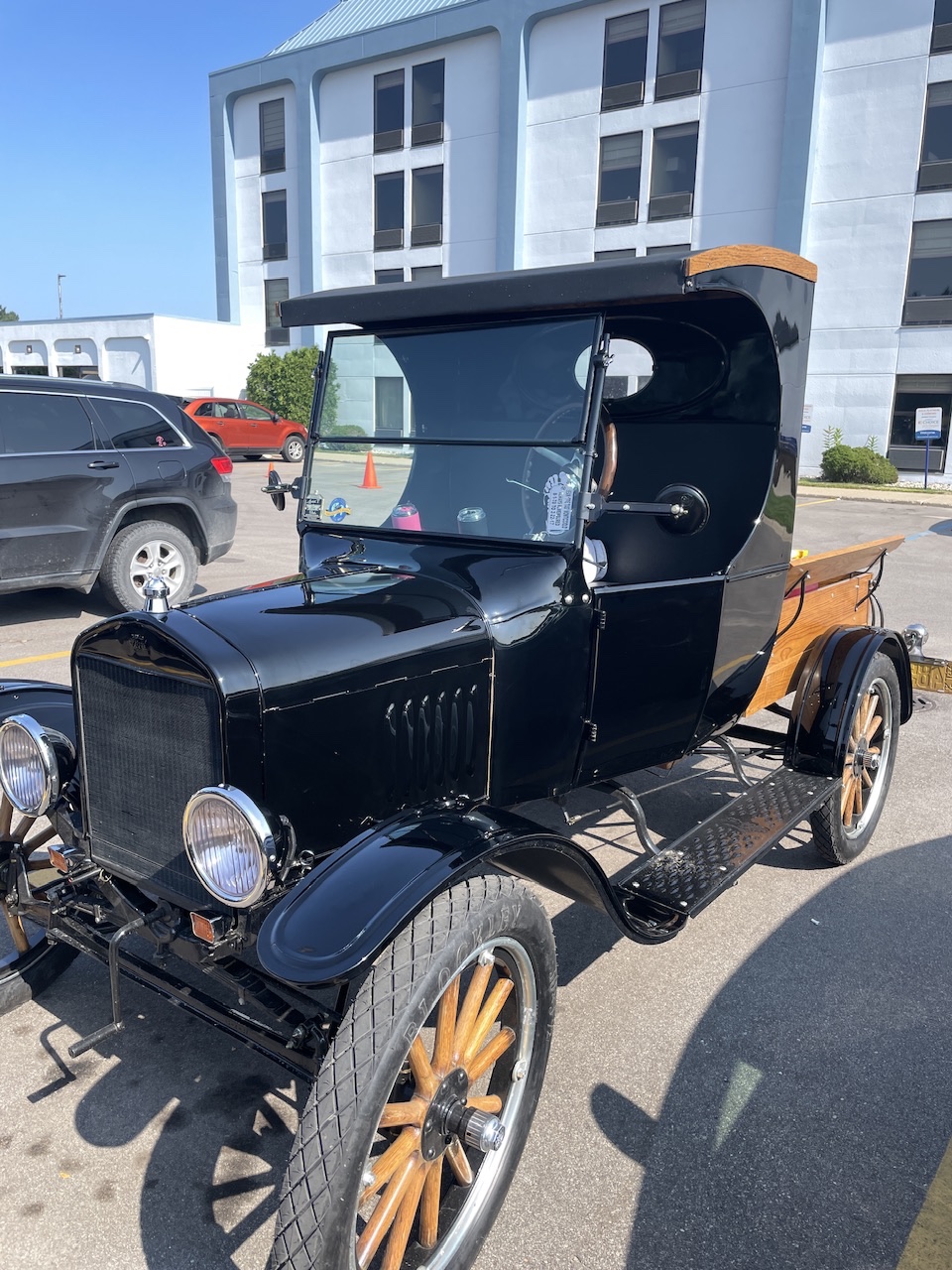

Hey Dan, Thanks for using my C Cab ( nice photo ) in your explanation of Blockley's. They are working good for me so far!!!!!

"The tire industry consolidated tire sizes and the clincher tires sizes were back then 30x3, 30x31/2 and 31x4.
The oversize Ford clinchers today represent that, as they are really 31x4, and fit the 23” rim."
This really has me confused. That Samson 30 X 3 1/2 that was tucked up inside my spare tire cover was much smaller than the modern Riverside I tried to make fir in the carrier. Would that mean it would have to have been made prior to April of 1917?

Paul, with no wire in the bead, clincher tyres will shrink if not fitted to a rim. I battled a set of 5 new old stock Olympic tyres to get them to fit onto rims. They had shrunk in circumference at the bead by almost 3".
I am not surprised your old Samson appeared smaller.
