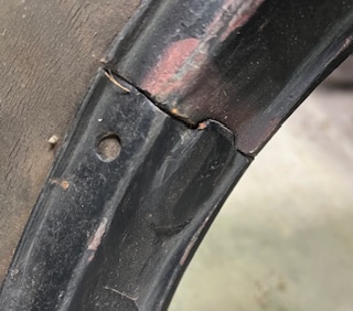

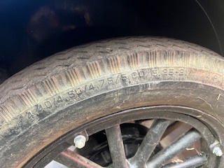

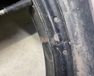

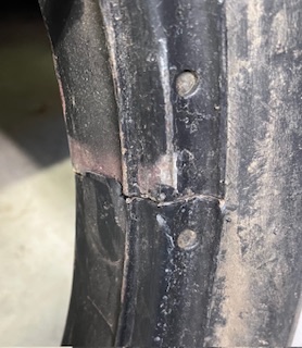

As I hunt for a spare rim, I want to make sure I match the four that are on my ‘26 coupe. I’ve attached a few pics if anyone can figure out what I have and what I need to look for. Any help would be appreciated.

26/7 Canadian Ford split rims

The only difference is that the Canadian ones have the holes near the split rim for the spreading tool, also yours has a home made split lock. I have bought USA rims before and used on Canadian T and fit OK.
