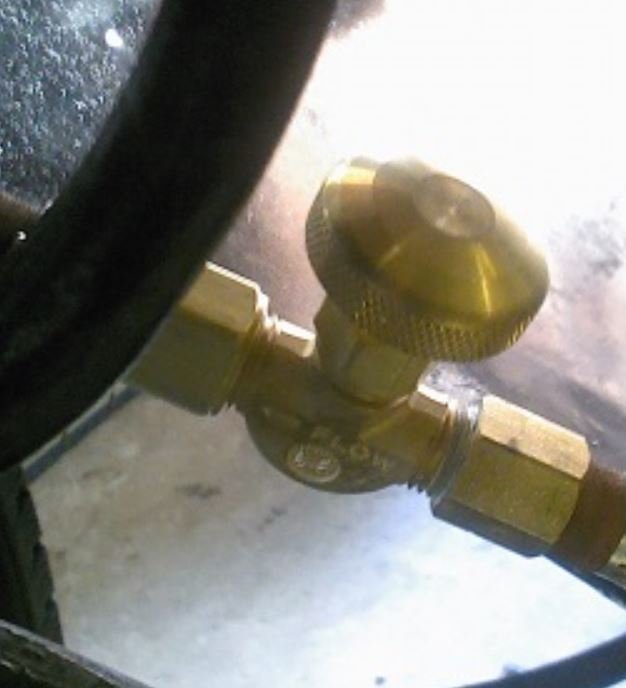

I use a acetylene regulator to check my burners before I put them in the headlight. I put the burner in a small vise and run a hose to it, crack the regulator to about 3 psi and check that they burn correctly. A small in line valve before the burner helps when you use tank acetylene.
The burners are different than a torch in that the oxygen is introduced from the side after the acetylene leaves the port we are talking about.
I have run three Prest-O-Lite B tanks through the set of 3/4's I have in the car presently. That is about seventy-five hours of night driving and they are as clean as when I put them in. They will get some smudge on the exterior of the ceramic but nothing on the small port. I think that is from the propane lighter I use to light up.

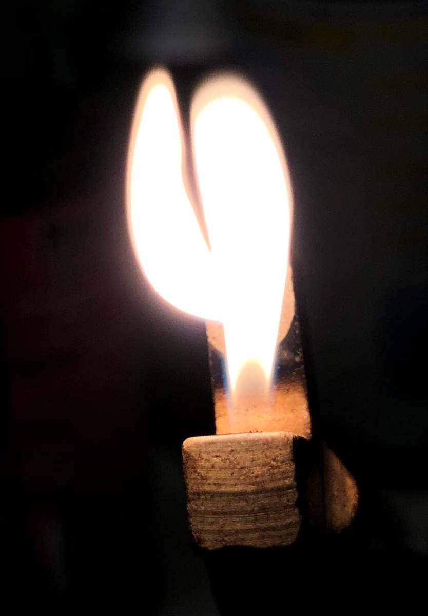

The flames bypass each other.
I have three elements that do this, and one that works great.
Greg
