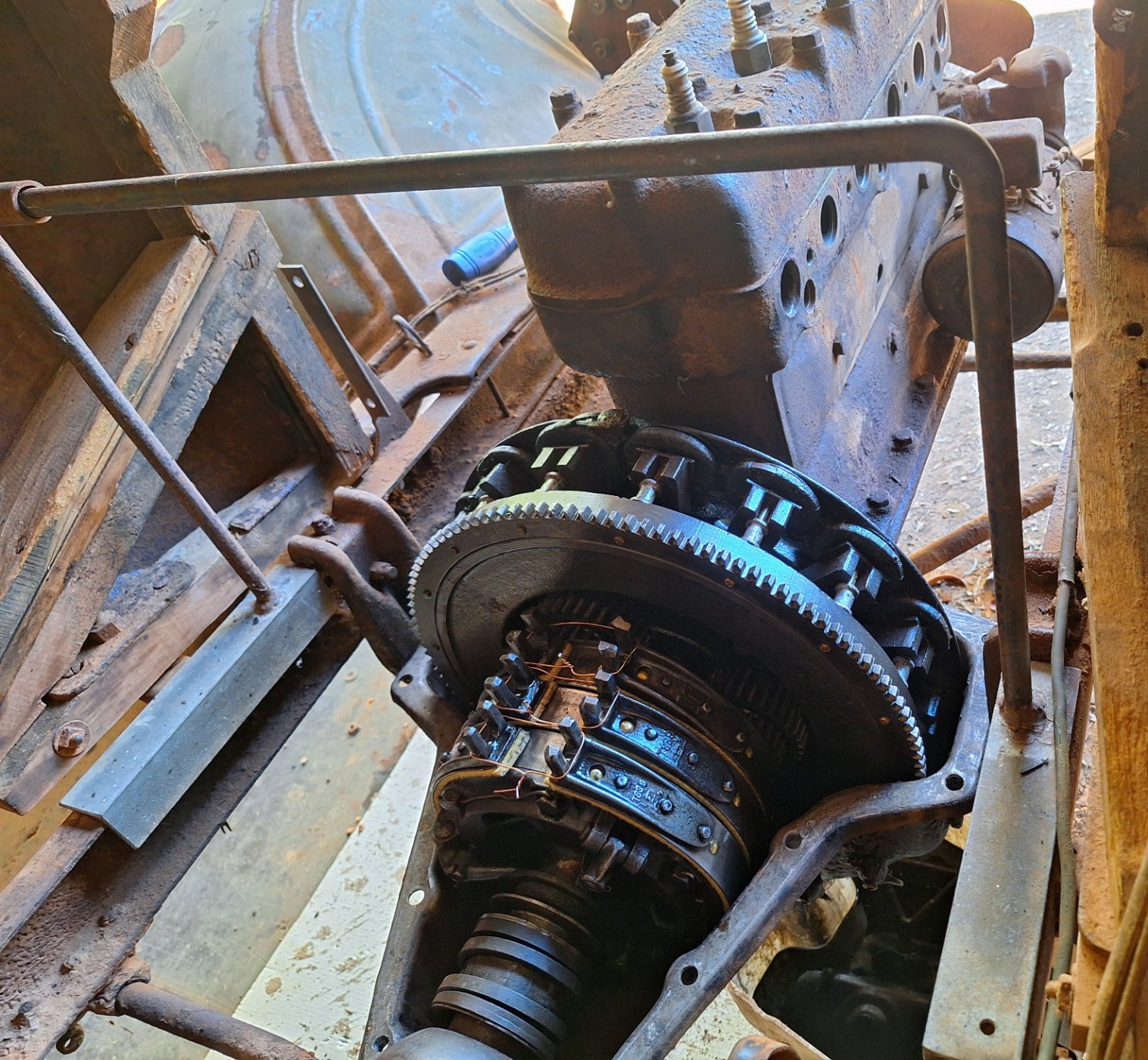

Removing the HH takes more time and effort, but for me it has been worth it each time. It is easier to make a tough mistake trying to go through the inspection cover. Ford may have implemented the "quick change" band later on, but the hogshead/inspection cover was never designed for the procedure. Plus with the HH removed you can get a good look at everything in there before reassembly so you can be more sure of all that work you just did.

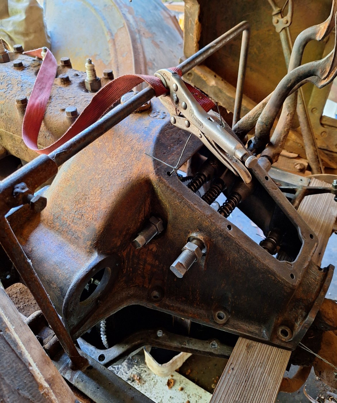

I made this helper that allows me to do the job on my own. It is specially useful with the heavy cast iron covers.

Allan nice set up but my fingers are hurting just thinking about those vice grips slipping off.

John, they are there to allow the cover to be lowered in stages, without me having to support the weight of the cover. Once the pedal rods are lowered to contact the ears, the vice grip holds the cover in place while I manipulate the springs and ears on the pedal shafts. Then it can be dropped a little more, and the ties on the bands removed before lowering it right down.
Our first gear band is the internally adjustable one on a RHD car. I fit the cover with the washer and nut in place, rather than risk dropping either into the abyss No need for stuffing rags tat get in the way. You could do the same with your reverse and brake washers/nuts.

I agree wholeheartedly Tad!! That's basically what I said above too...and everyone's forgetting (maybe) this '14 likely has the ALUMINUM, lighter hogshead! I'm tellin ya, removing the firewall is worth the hour or so of work to do it. Been there. And I don't care what anyone says, any "removeable item" inside that hogshead is just dying to fall INTO the pan!! That includes those pesky removable band ears. Since the author hasn't replied back with further info, who knows what he's working with.Tadpole wrote: ↑Mon Aug 05, 2024 3:34 pmRemoving the HH takes more time and effort, but for me it has been worth it each time. It is easier to make a tough mistake trying to go through the inspection cover. Ford may have implemented the "quick change" band later on, but the hogshead/inspection cover was never designed for the procedure. Plus with the HH removed you can get a good look at everything in there before reassembly so you can be more sure of all that work you just did.

Tim any removable object is just dying to get loose! That is why I fit the band adjusting nuts and washers 2 or 3 turns before fitting the cover. There is then no risk of dropping them into the trans. Saves rag stuffing and associated angst.

Good thoughts too Allan but of course that's if you put the H.H. back on with all 3 pedals on it. I've found it much easier to take off the Reverse & Brake pedal, put the H.H. on and then put those pedals back on. Seriously easier. What I do is I adopted from another poster the use of dental floss on the adj. nut as well as the washer, be damned even then with a friends job it still busted out! I got it with my "magic magnet tho"! Can laugh now, sure didn't then!! It's just an opinion, we all know each guy has to do what works for him.Allan wrote: ↑Wed Aug 07, 2024 3:13 amTim any removable object is just dying to get loose! That is why I fit the band adjusting nuts and washers 2 or 3 turns before fitting the cover. There is then no risk of dropping them into the trans. Saves rag stuffing and associated angst.

Tim, you guys have twice the chance to drop stuff into the abyss that we have. I don't take the chance with just one nut and washer, let alone two. Each to his own, but if you have ever had to take the cover off again to retrieve a nut, my alternative looks most attractive.
