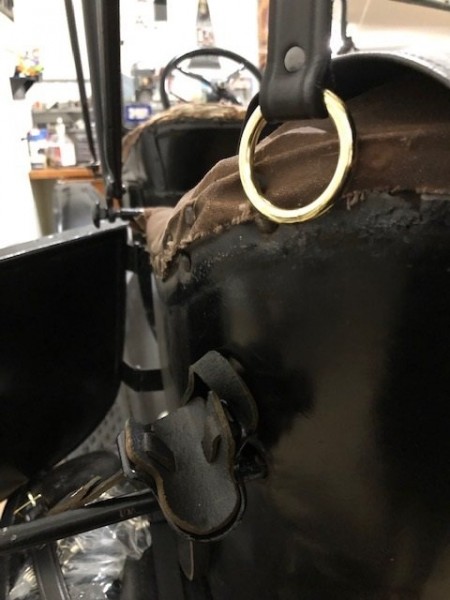

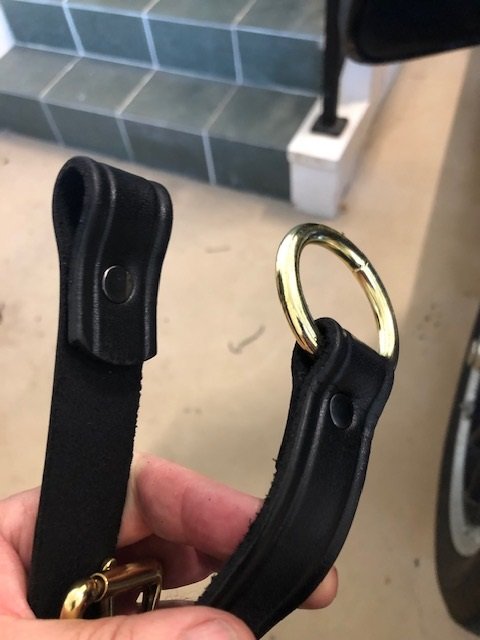

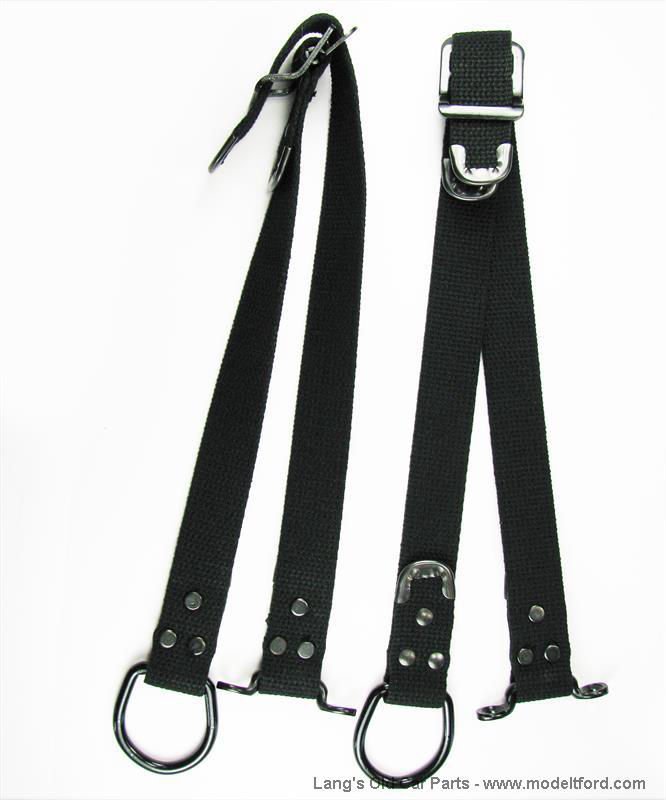

Do I really have to cut or drill the rivet out of the lower D ring off the rear curtain strap and nail it to the tack strip? Is there another way to mount it without taking the D ring off for a 1922 touring 2 man top?

This old thread http://www.mtfca.com/discus/messages/179374/229470.html has multiple pictures of the rear strap mount. None of them are like a 1922 which has the bow saddle rods straight out to the sides. The strap isn't long enough in any case to reach the rods. How are they supposed to go on? I would rather not sacrifice the ring if I can.

The straps you purchased are not made to fit the 1922 touring car. The straps with the ring fits 1911-1920 tourings and runabouts that have the "L" bracket and top saddle. For your car, a cloth strap was nailed/tacked to the top bow and then nailed/tacked to the tack strip.

Thanks, since the kit did not come with that then I think I will get a small piece of leftover top strap cloth, pass it through the ring and nail 'er down.

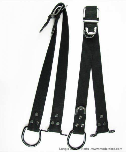

The rear and front straps are never sold with any of the top kits, you're supposed to buy them before you start assembling your top and you buy them from Langs. They are a web belt strap, 1 inch wide and have friction buckles, similar to what you see on web belts for pants. One end nails to the outside tack strip on the rear of the touring, the other end has the friction buckle, then the top side of the rear strap has a footman's loop which attaches to the inside the rear corner of the rear top bow, the other end goes in that friction buck and is pulled taunt, this stretches the strap webbing (2 inches wide) that goes across the bows from the rear to the front about 16 inches from the center of the bows on both sides and makes for a really firm surface for the top deck to be fitted to. DONT USE TOP MATERIAL FOR THOSE REAR STRAPS! They will not hold, it'll tear and then your top will be compromised. Buy the correct straps from Langs and do it right the first time, because if you do what you just said you'd do, you'll be take the top apart to re-do it and then it'll be harder to reposition the top deck and curtain because they're already trimmed.

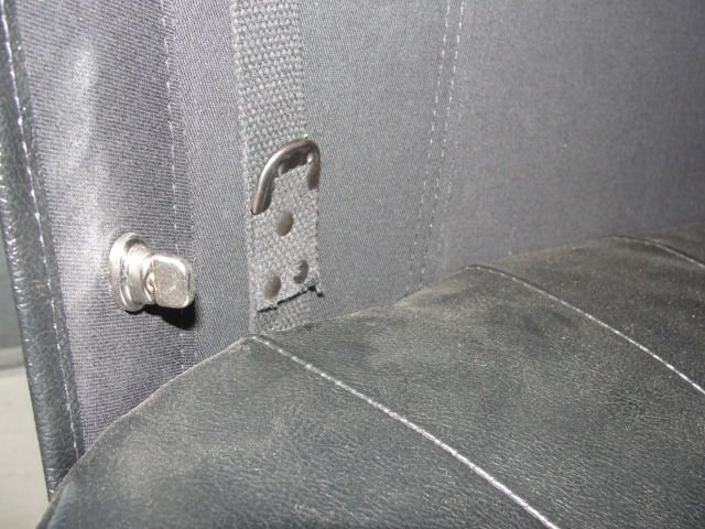

Rear Straps, notice they come with those bloody useless "D" rings? Just cut them off, that's what I did and don't worry about the bloody rivets showing.
7831SWB
This is what I did, notice that I cut the strap high up near the rivets, used that portion of the strap to nail it to my tack rail. But if you remove those rivets, you run the risk of the webbing fraying. This worked for me and I didn't have to worry overmuch about any fraying.

Now these aren't cheap, they're about $53 and change for the rear strap pair and about $85 and change for the front pair from Lang's, but they're better than using leather or scrap top fabric and correct for your car too.

Ignacio, I am the one who makes the cotton web strap sets that Martin showed you, and which Lang's and Snyder's carry. As he and Russ have pointed out, the set with the D rings was used 1915-21 on cars that used the L-irons to hold the top rest saddles. On your '22, the bottom strap has no D ring but is nailed directly to the belt rail or tack strip on the rear seat back. Send me a PM and I will build you a set for your car.
