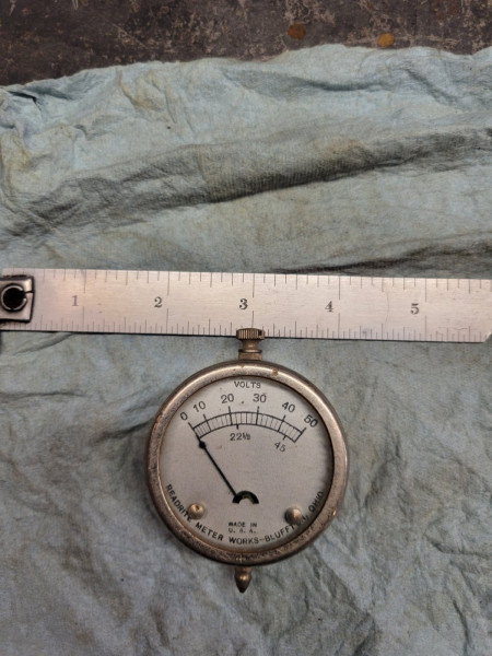

What is this?
Post by got10carz » Wed Aug 14, 2024 4:27 pm
Volt meter says Readrite Meter Works Bluffton Ohio.
With the 22 1/2 highlighted makes me wonder if it's for checking Mag output?

Post by Jerry VanOoteghem » Thu Aug 15, 2024 6:27 am
It's for checking radio batteries. In the early to mid 20's, radios were battery powered. They used "A" batteries for the tube filaments @ 6V, and "B" batteries for the tube "plate" voltage, with taps for 22-1/2 & 45 volts.

Re: What is this?
Post by Erik Johnson » Thu Aug 15, 2024 9:26 am
It's a typical 1920s pocket DC voltmeter.
It won't work for checking Model T mag output which is AC.
It can be used for a variety of applications, not just radio batteries.
It's a common item - not rare. I have a couple of them and regularly see them at estate sales and swap meets. I also have a pocket ammeter.
They usually have a wire with a probe attached to the top terminal or a permanently attached wire.

Re: What is this?
Post by mtntee20 » Thu Aug 15, 2024 11:48 am
NOTE: While it would work for 6 volt batteries, it would not be too accurate. ALL gauges and meters are most accurate at approximately middle of the face range. Thus, the 22.5 volt spot, would be accurate while the 6 volt and 45 volt reading would be "close" but not as accurate as 25 volt, exactly at mid range.
Thus, the designer had determined the 22.5 volt reading as being the most important, to ensure proper operation of the device being inspected, but required a 50 volt maximum to include the 45 volt secondary inspection point. Starting the range at 0, the meter could be used for low voltage DC measurements and MIGHT be close enough OR just serve as a "Go / No Go" indicator.

Not sure what you're getting at. If you've ever operated an early 20's radio, you would notice that they'll operate just fine at anything even close to the specified voltages. For that purpose, this volt meter is more than adequate.
