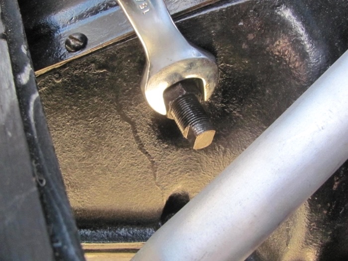

Believe that extension threads over the end of the flats on the low speed screw, like a cap, to present a hex face for turning.
Maybe useful, if perhaps one old has rounded off flats, but the regular flats help to control half twists at a time for adjustment, maybe some like a hex for using a box wrench or socket :?:

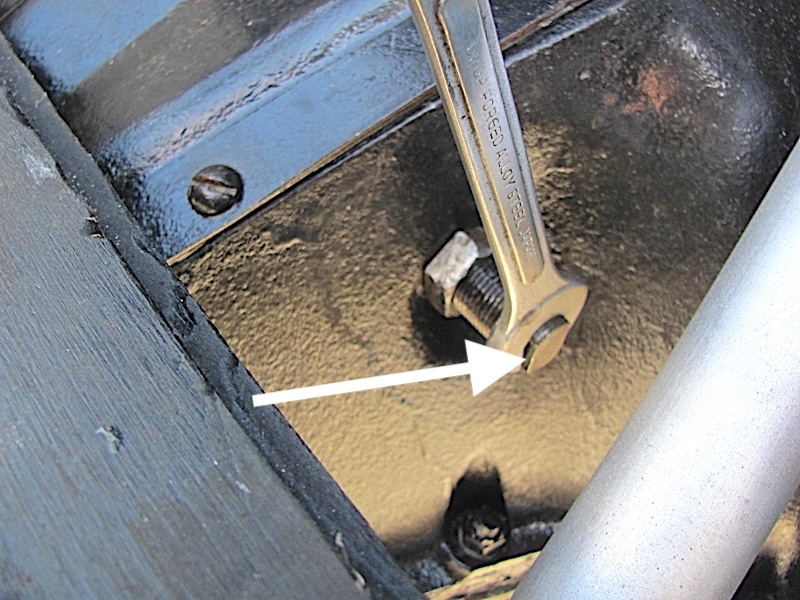

That is likely the use, from the photo didn't see a thru hole, figured it was a cap. :roll:
Makes sense as sometimes that lock nut is hard to move, as usually only a portion of the open end wrench can grasp it, due to the concave opening there.
