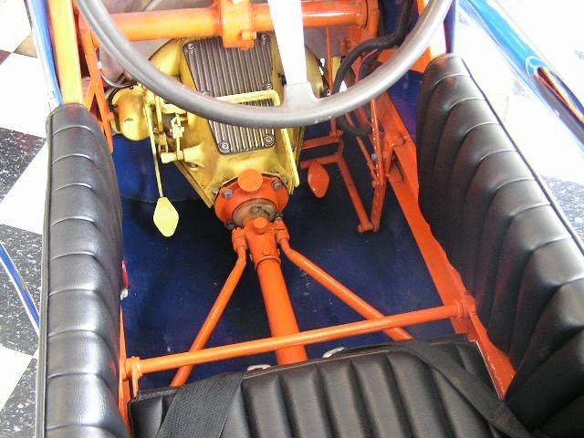

- Posts: 4383
Re: Speedster Center Steering.
Years ago, I knew someone that had a real original one man model T racing car. Narrow body, driver sat in the center. The steering gear was mounted on the frame rail alongside the engine. It was some sort of era common gear type steering column. The brackets held the gear crooked, and allowed the column to angle over such that the steering wheel was basically centered in the body behind the engine. The column was crooked, the steering wheel was crooked, and the pitman arm swung crooked. It connected up to the front axle just fine and steered just fine. The fellow said that although the steering wheel was crooked, after a few minutes of driving it, it felt just fine and was fun to drive!

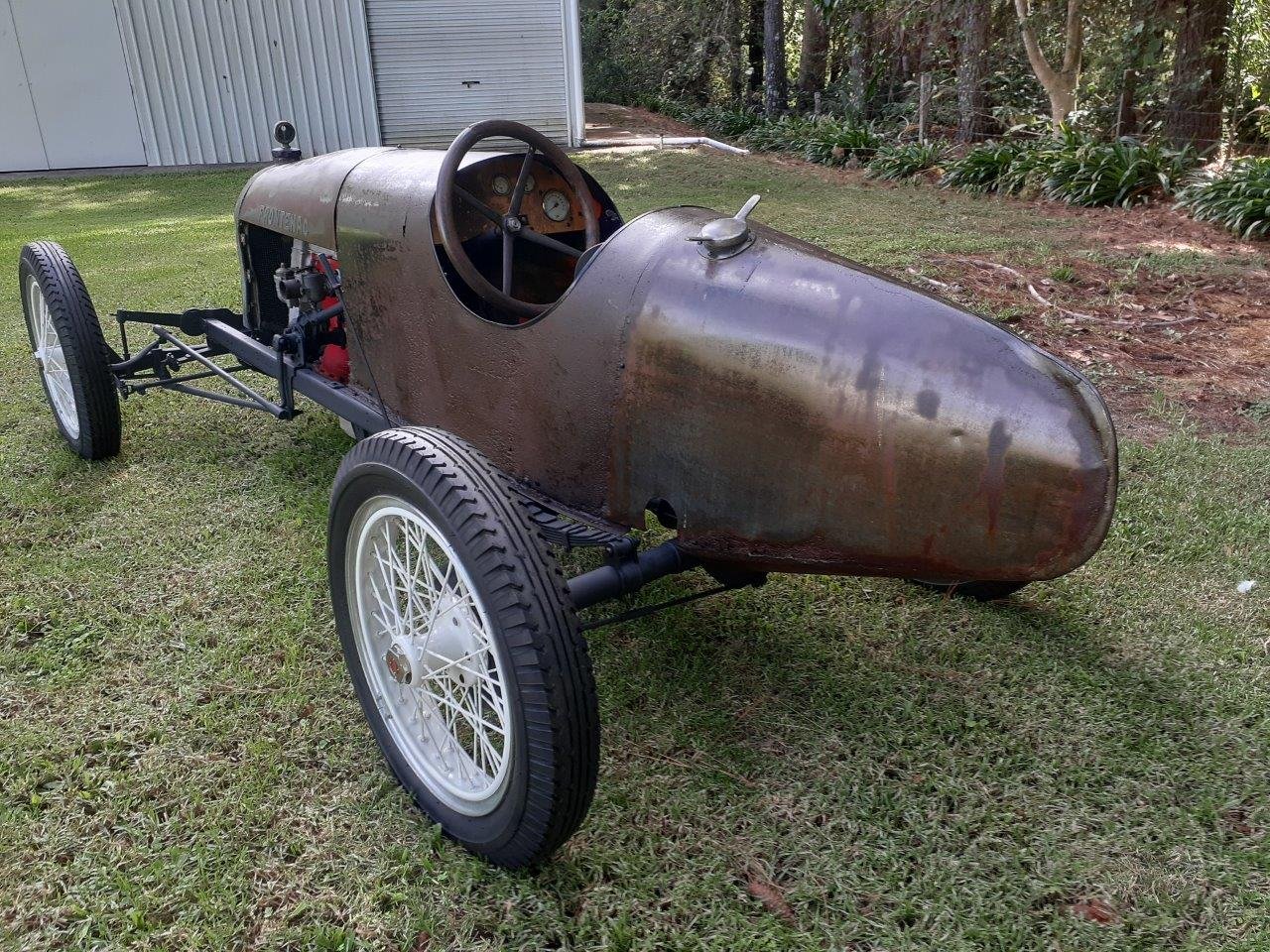

Think this is what Wayne is talking about

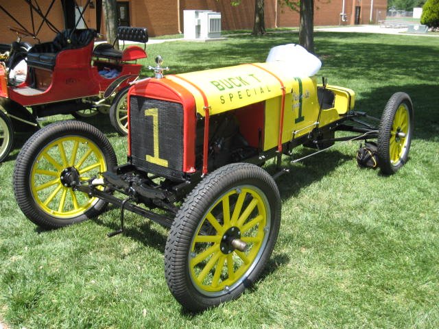

This is Tyrone Thomas car. Some other mod's done to it

- Posts: 4383
The Tyrone Thomas car posted by Frank B I think has a Franklin steering gear in it. I have never had a good opportunity to see one in a Franklin automobile, to see where, how, or why it is the way it is? But they were popular way back in the day for racing cars, and continue to be desirable for restoring or recreating era racing cars. Mounting the gear above the model T's transmission with their unusually long pitman arm shaft sets the steering column square with the car and eliminates having the steering wheel crooked in narrow one-man racing cars.
Both methods were used in the era on one-man racing cars. the few degrees crooked steering wheel wasn't enough to cause any serious issues even at racing speeds. But a lot of people thought being square with the car was classier and somehow better.

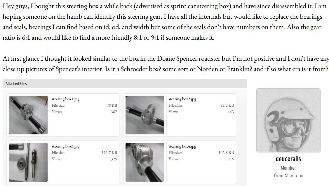

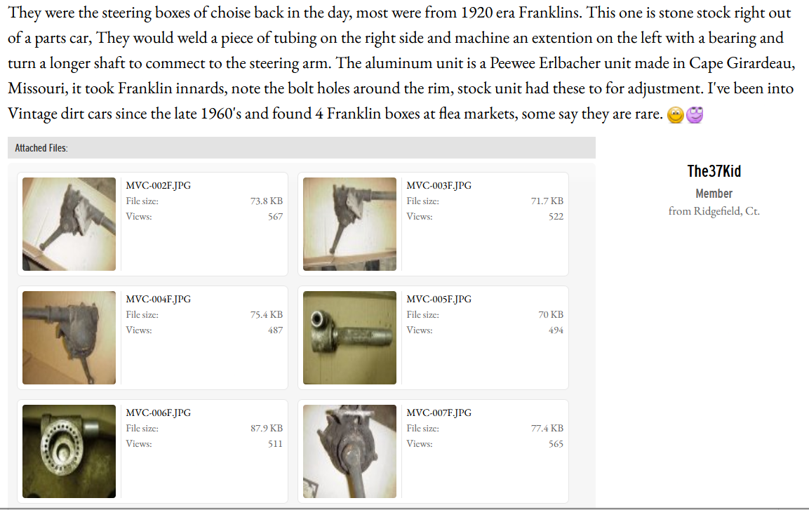

More info on the Franklin Box https://www.jalopyjournal.com/forum/thr ... es.328066/
However this looks similar to the one in Tyrone's car but not the same
Its a Schroeder box https://www.jalopyjournal.com/forum/thr ... x.1069944/
https://www.jalopyjournal.com/forum/thr ... ox.753434/ --
