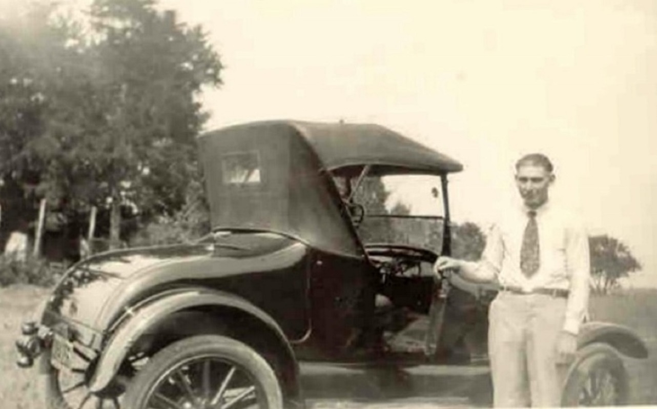

Determining if an original T or one from parts can be done with keen, knowledable inspection of body parts, assembly, engine number matching frame number (if made before late Dec. 1925), wear of chassis parts, and condition.
Early 1926 touring could be bought without electric so they came with kerosene cowl lamps, and non-demountable 30x 3 1/2" clincher tire wheels. These were the plain jane version, low price entry. As for cultural affinity, the plain Ford, in black was perhaps preferred, low price vehicle.
As for rarity, in 1925, 10% of tourings cars were sold as plain jane versions. So, likely same in 1926, 10% would be about 36,000 Model Ts, similar to this runabout below, plain non-demountable wheels, no rear spare rim or tire, black, and note the kerosene tail lamp, indicating without that new fangled electric starter and electric light equipment.

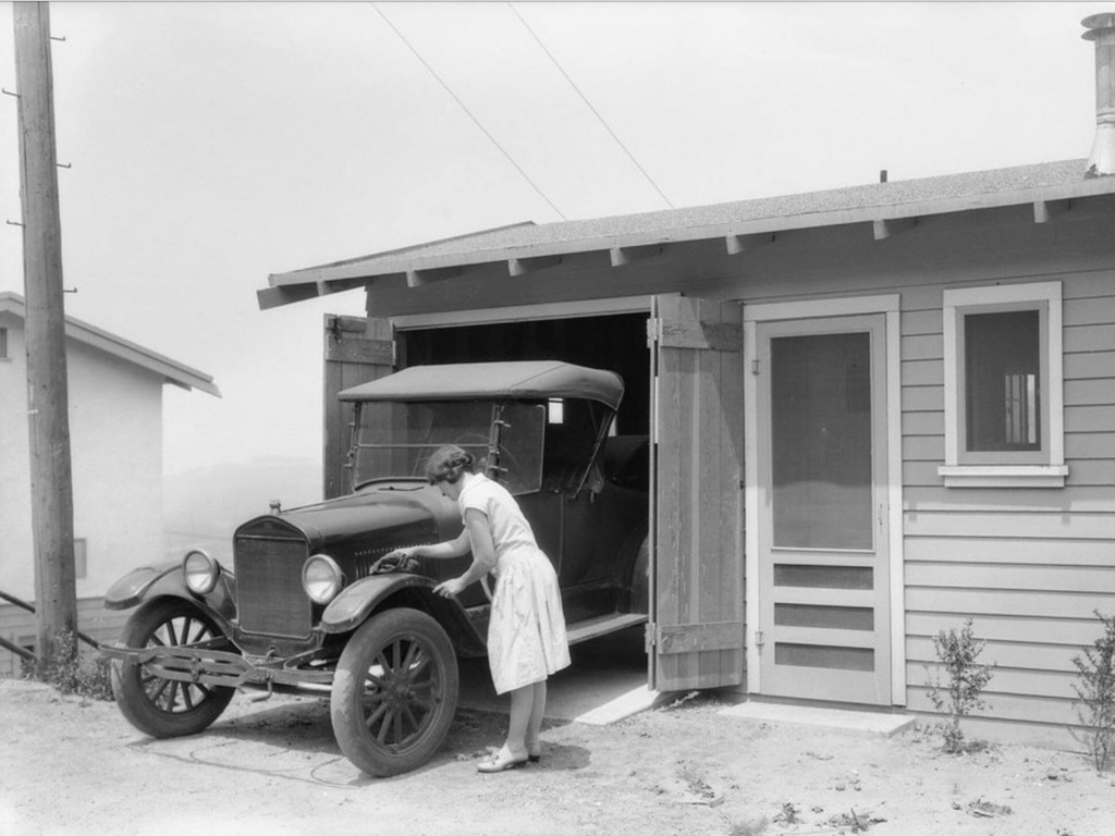

The plain '26 cars were considered "loss leaders" in that they sold for less than their cost, but allowed Ford to advertise an extremely low price, getting customers in the door. With ninety percent of customers upgrading to electric starting/lighting, etc., Ford came out well on top in average profit per car.
A plain 1926 car is very rare, and you have something worth preserving and appreciating. Not only was the car among the very few built like that that year, but it also survived later generations of enthusiasts who might have upgraded it for convenience. Enjoy it as it is, because it's basically the merging of two eras of automobile design and conception in one car.
Earlier brass cars sometimes had the brass painted over once brass trim fall out of style around 1912-13. It wasn't anything to do with higher powers, just fashion and trends in automobile design. By 1915 nearly all cars apart from Ford had painted radiators and nickel trim. Ford was way behind here, so the introduction of the all black and nickel cars in August 1916 was not only necessary, but also a big sensation, basically the "new Ford."
The photo isn't a "plain Ford" loss leader because they were rare and thus rarely photographed. Neat photo anyway.

Re: Plain 26 T touring questions.
Post by speedytinc » Tue Aug 27, 2024 1:25 pm
It was my understanding that non electric T's, as discussed had kerosene side lamps as standard equipment. I have seen them on such an original "economy" roadster.
The period roadster photo doesn't have the sidelights I would expect. Could the owner have removed them for a more modern look? Everything else fits. Even no top saddles. Holes plugged.
Post by Shannon_in_Texas » Tue Aug 27, 2024 2:46 pm
John, maybe they removed the cowl lights to mount the wind wings?
Post by speedytinc » Tue Aug 27, 2024 3:11 pm
The T in the garage is not a non electric? This T has demountables.
The first picture of the non electric T was what I was referring to missing cowl lights.
