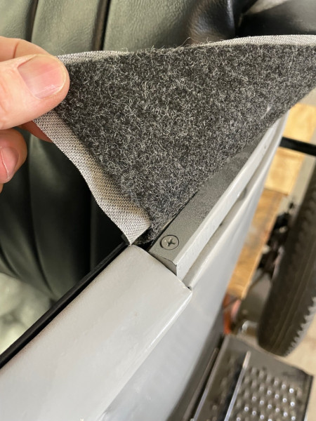

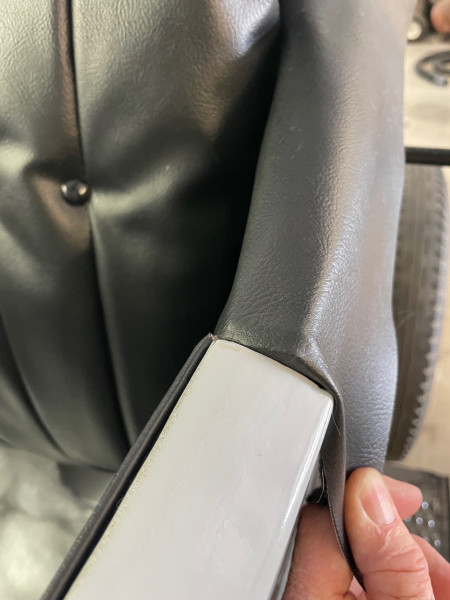

When finishing out/fastening the seat side panels, do you chamfer down the tack strip to meet the body panel armrest plane? Then slide the extra material over the tack strip and between the metal armrest side?

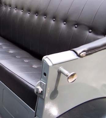

Yes, taper the tack strip, original wood tack strip was also tapered. Used that plastic strip on my '27 touring and did the same like factory, taper the edge down. The Improved open cars didn't use an end cap. Just finish off with Hidem Welt and a end trim nickel fastener.
Then fold under the leading edge of the upholstery about 3/8" to 1/2" to align with the metal edge of the body.
This install was without a top at the time, otherwise the Hidem is over the top cover edge.
Uphol side pad rollover large1 (550x367) copy.jpeg (41.19 KiB) Viewed 2327 times

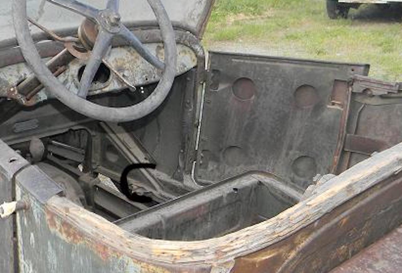

Original runabout wood is tapered.
