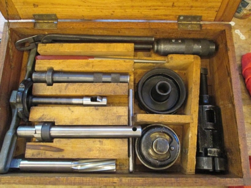

Down here in good old Alabama here is how we dos it .
Good old Stevens Speedup tools. Works every time.
Posts: 5604
Re: Tight drive shaft bushing…
Post by RajoRacer » Mon Sep 02, 2024 12:04 pm
I have & use the same tool Dan. Wife found the complete Stevens kit for me !

Steve, the pinion bearing sleeve puller in your kit is not necessarily up to the job. I was given one which failed miserably on a stubborn sleeve, The cast body broke around the groove. The threaded push bolt split under a load, which should have alerted the operator that something was amiss, before the tool was wrecked. I understand a later iteration of the same tool was made of steel and worked differently, so the cast body one may have been recognised as not necessarily up to the task.
Posts: 5604
Post by RajoRacer » Tue Sep 03, 2024 11:37 am
Perhaps, but I've removed many with it.
Posts: 7309
Post by Allan » Tue Sep 03, 2024 9:18 pm
I was just hoping to avoid any damage to a rare tool in a nice set.The sleeve that broke the tool I now have was finally removed by slitting it with a cut-off disc and then expanding it a bit. I think I would have done that before applying the load needed to bust the puller.
