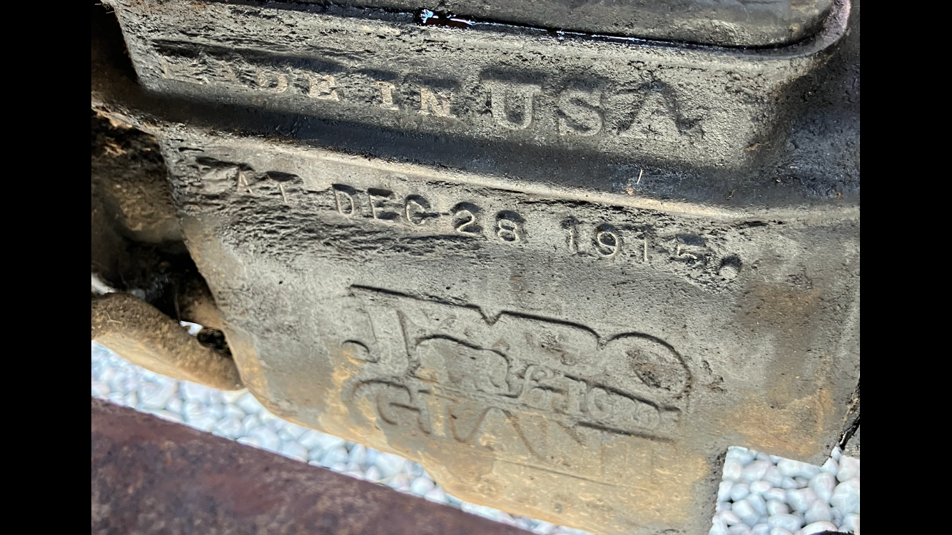

Helping a friend with a new purchase. TT and it has a Jumbo ppoverdrive. Seems to function properly. Need to change fluid. Not sure how full to fill and what oil. 600 W, 80/90 or ??? Anyone have one and could give some advise. Thanks

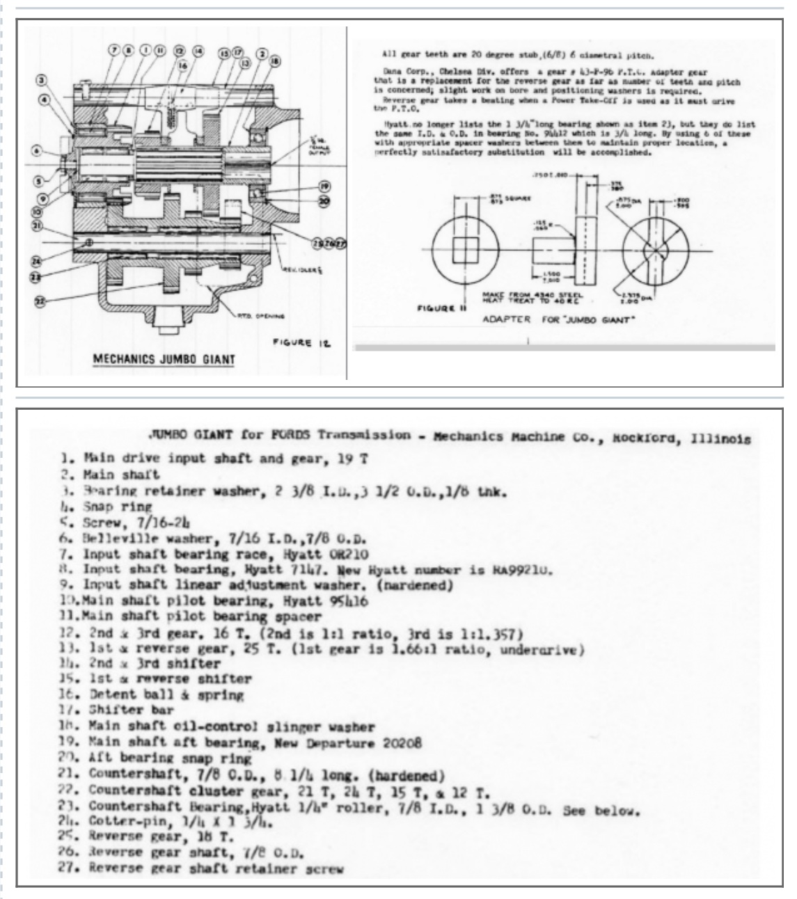

Decent auxiliary transmission. I don’t know the fill level for a Jumbo but with a Muncie or original Warford about 1/3 of the case with 85-140 is what I’ve seen. I’ve also seen the results of over filling sloshing out of the relief orifice. I’d encourage you to use a climbing oil product in addition. “ In 1923 the Price-Hollister company in Illinois began building the Jumbo transmission. Like the Muncie, this was a selective sliding gear transmission and in conjunction with the Model T Ford transmission, also produced 7 forward speeds and five reverse. Transmissions were provided for both the car and truck market, but in 1924, the company began producing the Jumbo Giant. This was basically a "beefed" up version of the Jumbo transmission, specifically built for the truck owner.” Attached is information you may need for you friend courtesy of Frank Brandi

RE the adapter: I have to go check mine but pretty sure there is a spring that fits in the square hole that presses it away from the output shaft and helps keep it engaged with the tabbed part on the transmission but is not shown in above drawing.
- Posts: 5083
Re: Jumbo Giant transmission.
Correct.Mark Gregush wrote: ↑Tue Sep 17, 2024 11:50 amRE the adapter: I have to go check mine but pretty sure there is a spring that fits in the square hole that presses it away from the output shaft and helps keep it engaged with the tabbed part on the transmission but is not shown in above drawing.
There is about a 3/8" hole in the drive square for a spring that would press against the plug inside the output shaft. Not keen on that thinking.
The spring could loosen the plug, however it cant move far, backed by the clutch spring retainer cup pin.
The coupling shows how to make a usable part, its not showing an original part. The original nose is one piece forged, not welded.

I way overpaid on the last one ($400) I got looking at the gears from the outside but did get an original coupler. When I took it apart, the counter shaft bearings fell out like rain dropping in the cleaning pan. The other one I have, the bearings in the counter shaft had been replaced by brass bushings which were worn and spinning in the counter shaft housing.speedytinc wrote: ↑Tue Sep 17, 2024 12:17 pmCorrect.Mark Gregush wrote: ↑Tue Sep 17, 2024 11:50 amRE the adapter: I have to go check mine but pretty sure there is a spring that fits in the square hole that presses it away from the output shaft and helps keep it engaged with the tabbed part on the transmission but is not shown in above drawing.
