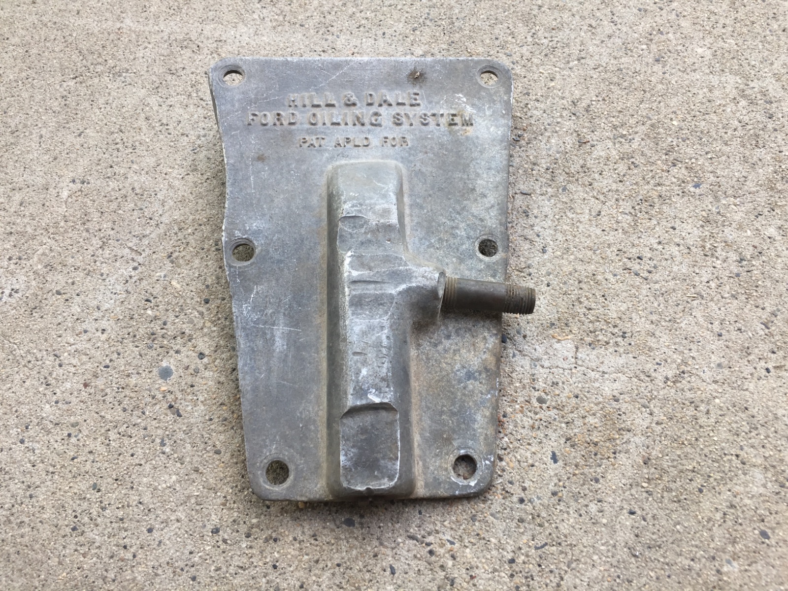

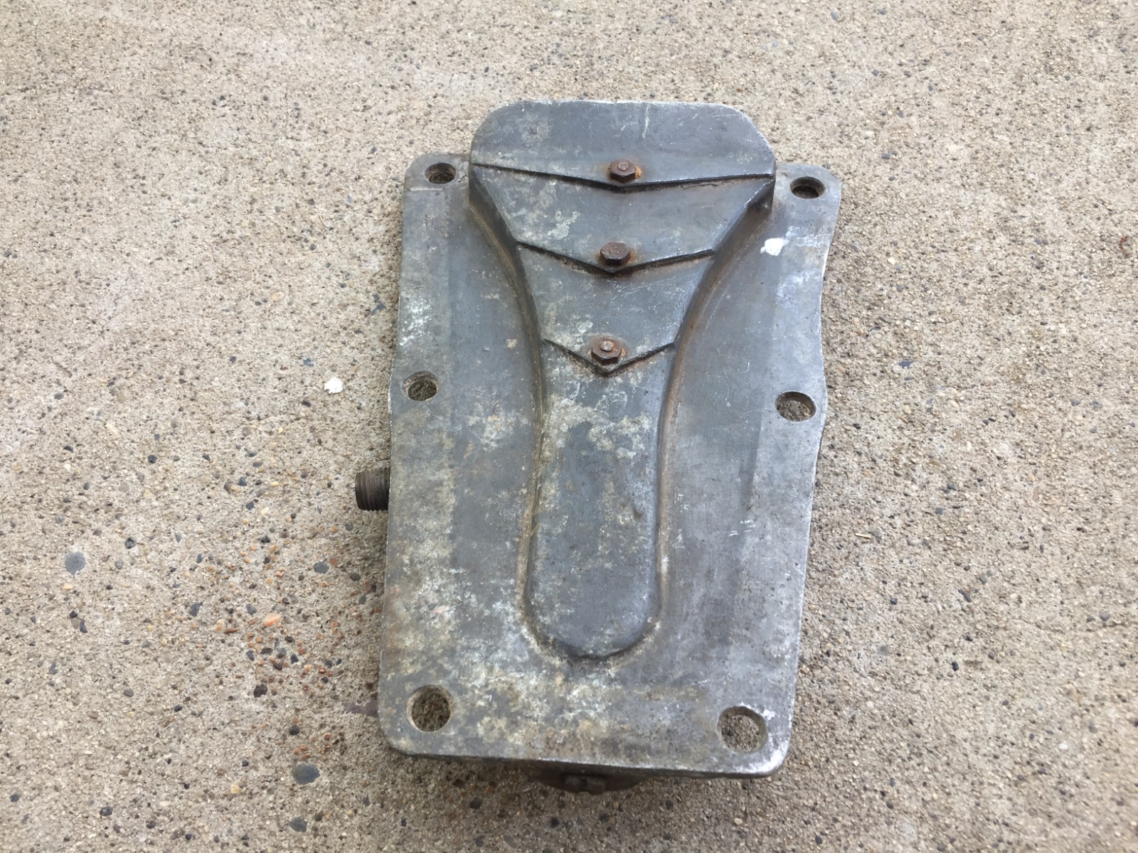

Option 1 Hill & Dale Note someone didn’t want oil on their bands!

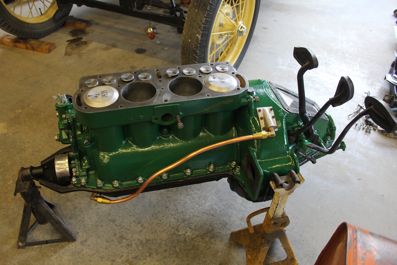

Option 2 Ford Faithful I use this on an engine stand because the oil line was plugged.

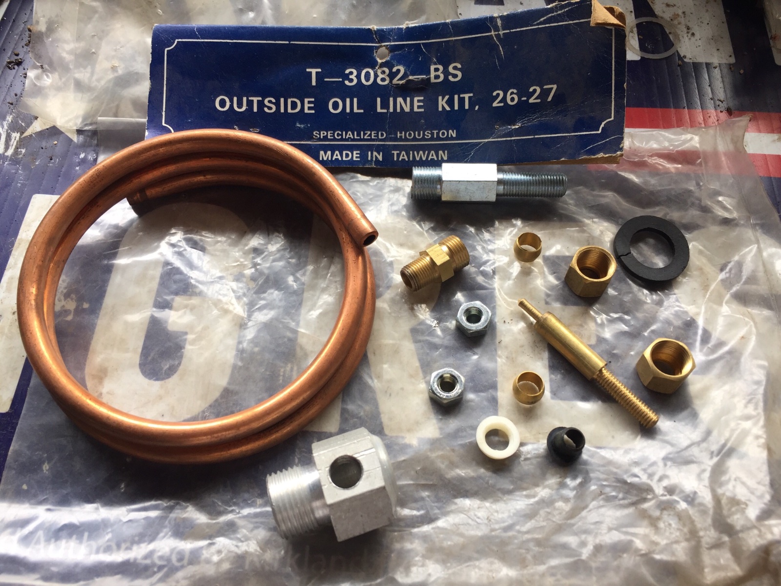

Option 3 NOS Modern Taiwan T-3082 BS this maybe 20-30 years old. The main assembly is aluminum.
I will show what I have and I am open to suggestions of what to use or avoid.

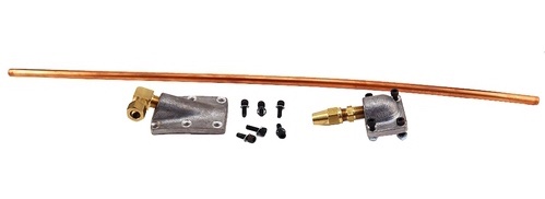

This is the best. A super high volume oil line. Install the oil pickup scoop on the hogshead in line with the magnets which fling the oil into the oil scoop forcing a high volume of oil to the front bearings.
Picture is from the Snyder’s catalog.
One of the first prototypes of this outside oil line was installed on my 1926 coupe by the inventor in 1979. Note that the other end is installed between #1 and #2 bearings high enough on the crankcase to splash and spray the oil on the piston bearings as well as the crankshaft bearings.
I think the worst outside oil line is the one that utilizes the magneto post housing. There are just too many tight restrictions and turns for the oil to take before it gets to the front and then it is only a trickle. You can see how little room there is for the oil to get up into the outside oil line by the picture looking up into the mag post housing when the fitting is tightened. The tightened fitting can also ground out the magneto if the fitting touches the mag post. A bad design all the way around.

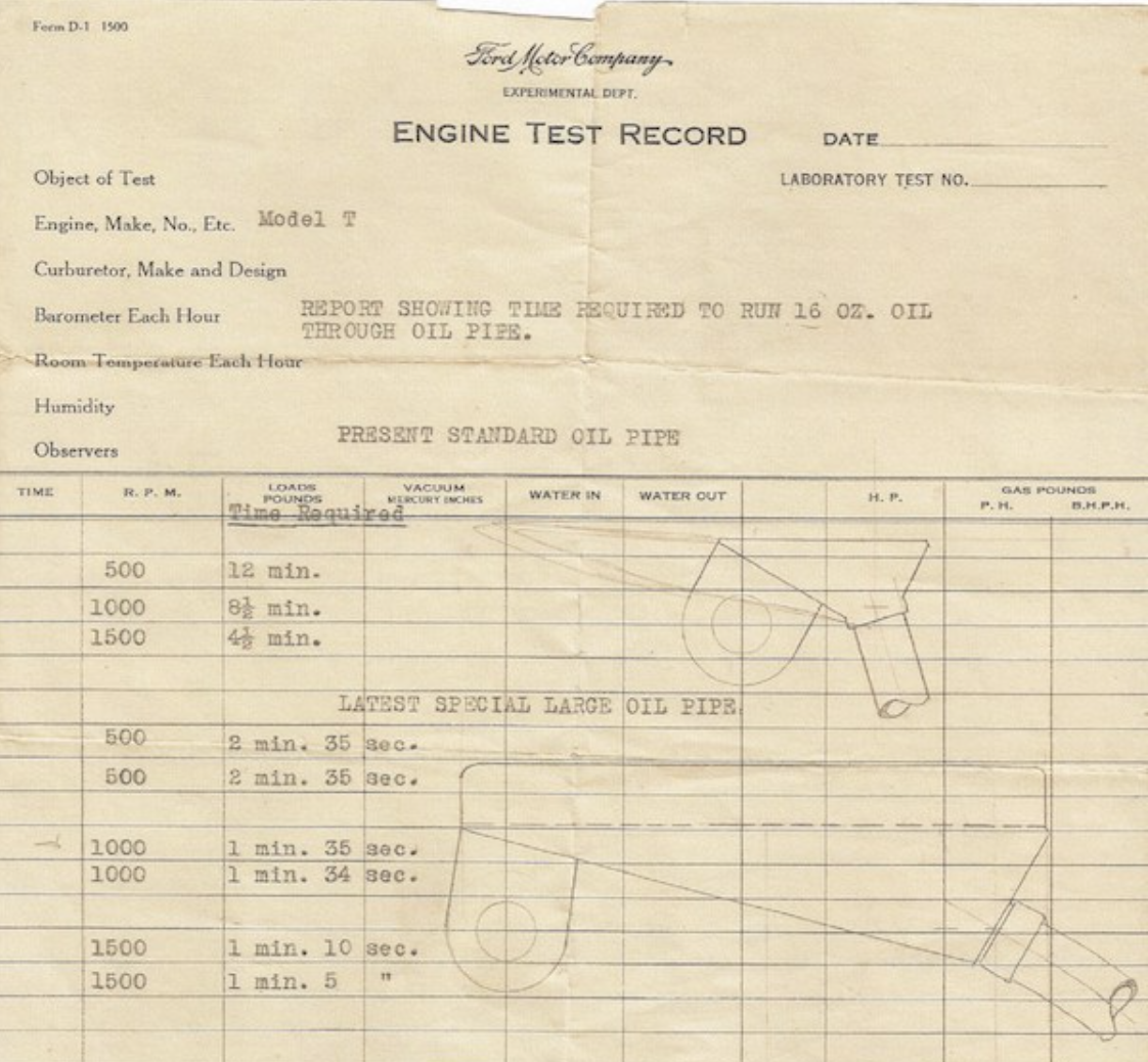

Jim Patrick gives the origin story from 1977 for the hogshead scoop type outside oil line here: https://www.mtfca.com/discus/messages/2 ... 13252.html One important point Jim makes is that this is a pressure fed outside oiling system because the oil flying off the flywheel, ring gear and magnets.
The following is Texas T Parts T3081-HVOL • High Volume Oil Line Kit: http://www.texastparts.com/mm5/merchant ... y_Code=New
Flow: 1 minutes/gallon @500 RPM Texas T Parts Test Results: https://www.texastparts.com/mm5/manuals ... esting.pdf
Maximum Grade: ? (Likely this system would provide oil higher than any other system because of "pressure" off flywheel.)
Price: $127.75 (Lang's version 3081HVOL2 - $86.50)

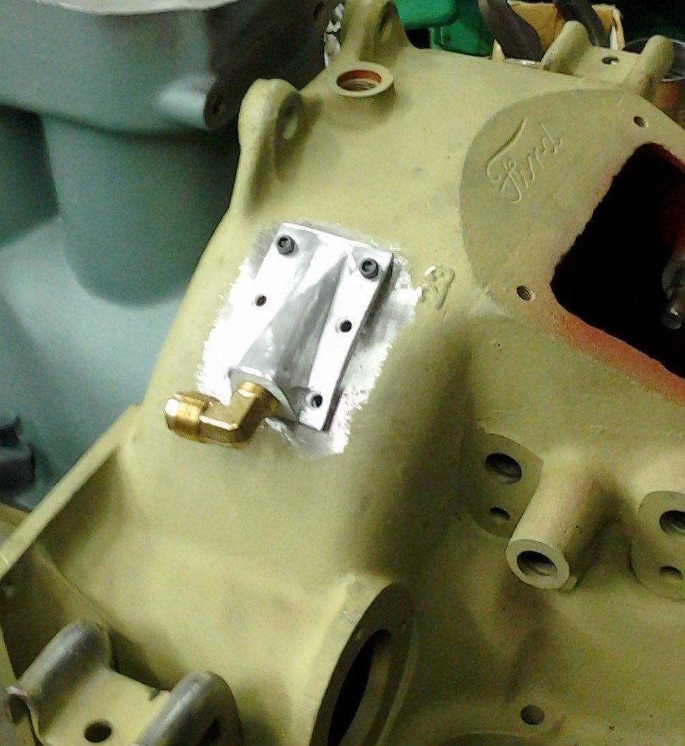

Mag. Post Oil Line
Flow: 14 minutes/gallon @500 RPM Texas T Parts Test Results: https://www.texastparts.com/mm5/manuals ... esting.pdf
Maximum Grade: 44% (based on 19 5/8" length with an 8 5/8" rise)
Price: $32.95 Lang's 3082BOL kit

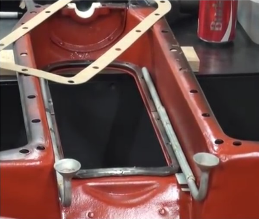

I noticed Pat Kelly's post on the internal oil lines. I have never notice these existed!
Maximum Grade: 17% (based on 16 " length with a 2 7/8" rise)
Price: $108 ($53.95 for the two from Lang's 3081ACC & 3081ACCP @$53.95 each)
Mag. Post Oil Line
Internal Pan Plate Oil Lines
I found the following image on this thread: https://www.mtfca.com/discus/messages/8 ... 1516815784 I also found that Fred Houston shared his experience with the inside oil lines here: https://www.mtfca.com/discus/messages/1 ... 77128.htmlkelly mt wrote: ↑Mon Sep 16, 2024 12:41 amI run in the steep mountain roads here in Montana and run two types of oilers. One car runs the stock oiler plus the hogs head high volume type. The other has two inside oilers plus the mag oiler. I don't run a mag so the "obstructions" are removed from the mag post. Long steep pulls are routine with no problems.
Flow: ? (Perhaps each would give similar to the standard Ford internal line.)1) THE FOUR TUBE "PERIOD CORRECT" OILING SYSTEM. The four tubes or oil lines are; the original internal oil line, the common accessory oil line from the magneto plug to a pan bolt at the front of the engine. Two accessory oil lines installed on either side of the oil pan dipper plate. These two internal oil lines will flow up to an 17% grade, while the standard oil line will flow until a 20% grade is reached, while the outside accessory mag post oil line will continue to flow up to a 44% grade. An additional quart of oil is advisable when making a really long pull such as Pikes Peak.
2) Oil line Ratios: Standard internal oil line, 19 5/8" length with a 4" rise (20%). Magneto plug oil line 19 5/8" length with an 8 5/8" rise (44%). Pan plate oil lines 16 " length with a 2 7/8" rise (17%).
3) We climbed Mt. Evans in Co in our 13 runabout, over 14,000 feet with this system and had no problems with either oil or fuel. It sure was fun! I'm ready to try Pikes Peak!
4) Folks continue to knock the Mag post oiler. I get excellent flow out of mine. It needs time to fill the tube, but flows well once it starts. I don't know about the repops, as I always use an original. Available on ebay. I've purchased probably a dozen in the past 3 years. This post should raise the price on those babies!
