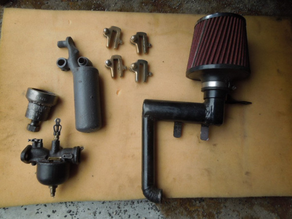

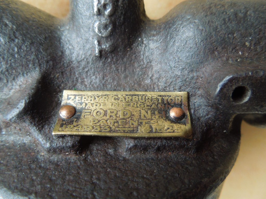

Post by Rata Road » Fri Sep 27, 2024 8:34 pm
I scored a very sound looking unit a few weeks ago for $10. Havent tried it yet but they have a good reputation, probably due to the model not so much they were made in the UK and tagged different.
[attachment=1]DSCN5014.JPG[/attachment]
[attachment=0]DSCN5015.JPG[/attachment]

Post by Steve Jelf » Sun Sep 29, 2024 10:55 pm
The only difference between a Ford F and a Holley NH is the name tag.
