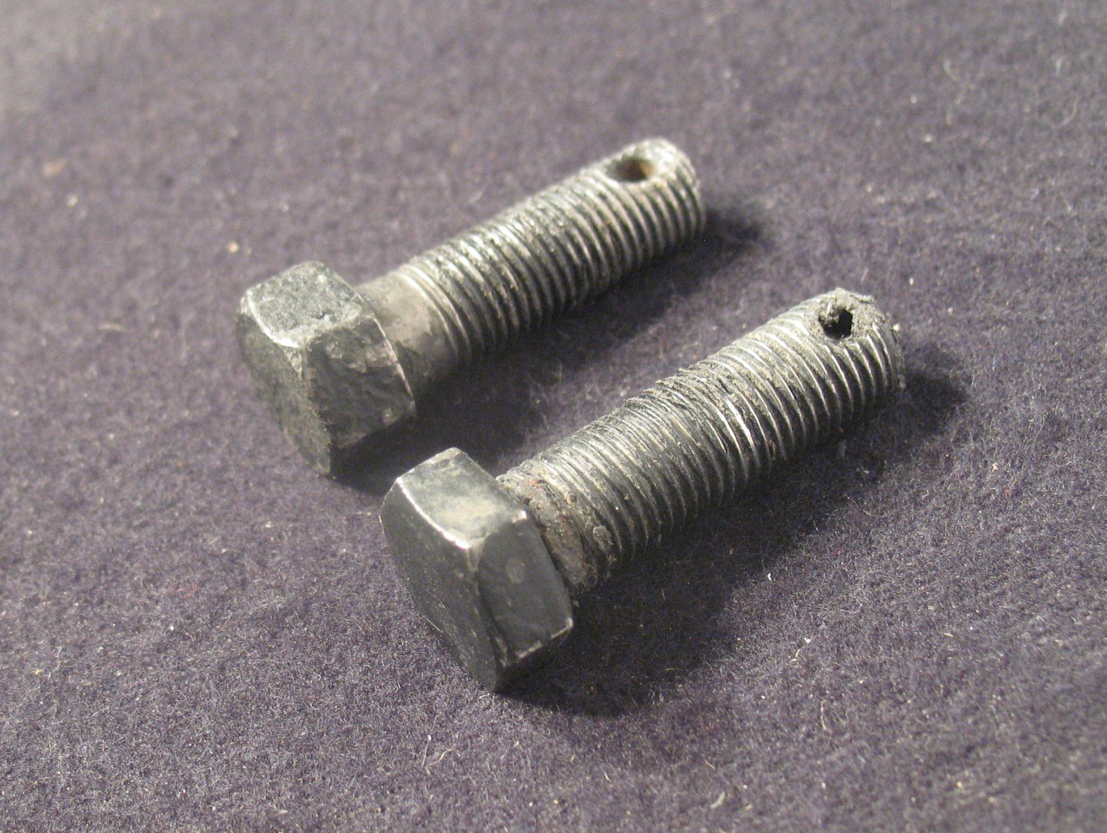

Nuts & bolts. You can buy the modern ones at a hardware store, grind off the markings, drill cotter pin holes, and get something similar that show judges won't notice. But compare an original bolt used by Ford and an adapted modern substitute. The difference is obvious. As far as I know, there is nobody reproducing the originals. Most of us don't even recognize the difference, but once you do it's hard to miss.

No offense Steve..... but I personally have zero interest in reproduction bolts and some judge's esoteric opinions on said topic, but I do care about being able to reliably start your car and actually drive it without breaking down too often! These cars were meant to be driven.

As to Steve's comment about bolts - If my goal was a 100 point Pebble Beach car I would agree with him. That is not my goal, and as long as the bolt head is square where it is supposed to be square, and no Philips screws, close enough.

I think Steve should have a look at the bolts Lang's is selling. I've been buying up originals for years, and was even able to build a car from scratch using all the correct nuts and bolts. It's always been important to me to do this.

I don’t think Steve was saying that making exact reproductions of nuts, bolt and other fasteners is a have to do for a Model T. Steve is right to give advice about how to fabricate modern bolts that closely look like the originals. I’ve done that as well as others to complete a car. Exact duplicate fasteners aren’t necessary for a good running car like a generator and starter is. For me an original generator and starter is more important than a fastner but that’s just me.
