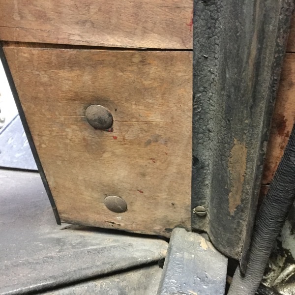

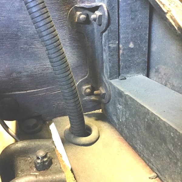

Post by DanTreace » Thu Oct 10, 2024 5:51 pm
Photo of location and bolt and nut types.

Posts: 7316
Re: 1915-1916 Butterfly Firewall Bracket....
Post by Allan » Fri Oct 11, 2024 2:55 am
Dan's photos are of an earlier car than 1915. They show a separate hood former with no metal cover over the firewall, and the first photo shows the earlier pan arm with the tapered down outer ribs on top. By the time the 1915 bodies with their metal covered firewalls came along, I think the butterfly brackets were not needed. It was 1992 that I finished restoring my 1915 tourer, so my memory may not be correct.
