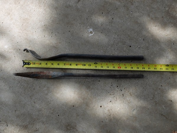

Having the right tools helps a lot. Before I tried mounting my first clincher a few years ago, I got the MTFCA video by Fred Houston on mounting tires. In it he showed using a special hooked tire iron that makes the job easier. There are no dimensions to it, but I showed the video to a blacksmith friend to see if he could make something like it. He made me three like shown in the picture below, from 3/4" spring steel. They worked really well. I mounted the tires with flaps on my living room floor. I used commercial tire lube that I got from the local tire store, and by the time I was done I was mounting a tire in less than three minutes after I had to tube and flap inserted in the tire.
Ralph

Picture didn't work; will try again.
Ralph

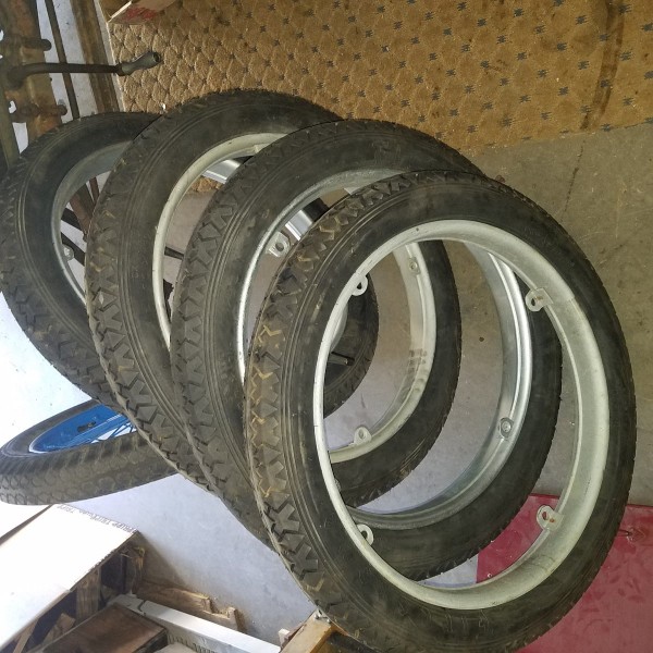

Well, mission accomplished with help from Gene; thanks a lot Gene!! :D
We removed and installed the tires with the rims on the floor. Stuffed the tube in the tire partly inflated after notching the beads for the stems, then levered both sides unto the rim together with tire spoons, using 4 hands and some liquid soap. At first we tried to insert the tire with flap and tube together as a unit but were unsuccessful. Ended up omitting the flaps entirely.
I estimate that all five tires (including spare) to remove and install took about three hours, with about a half hour of that total being due to a problem with a leaking valve stem that had nothing to do with the install.
Not an easy job by a long shot! :mrgreen:

Post by mngreen » Mon Jun 17, 2019 11:35 am
Original Smith wrote:
Sun Jun 16, 2019 11:43 pm
Some more on flaps. They go in easier when new. I recently had to change one that had been in the car for years. They get a little tempermental after they've gotten hard.
Larry, I think you hit the nail on the head! My flaps were in the tires for almost 10 years and developed quite a "set" in shape making them very hard to remove (had to use vise grips and four hands) and almost impossible to reinstall.
1924 Model T Touring

Post by KWTownsend » Tue Jun 18, 2019 12:47 pm
Yesterday I finished mounting a new set of Excelsior tires on my 1911. I opted to not use the flaps that had been in the old non-skids for the past ten years. In those years I had two flats. Front 30x3 at 55psi, rear 30x3-1/2 at 60psi.
