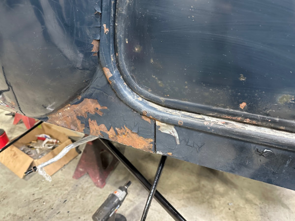

I am restoirng my 14 Runabout and everywhere I look I can only find traces of dark blue paint on the body. There is no indication of it ever being black except the fenders and running boards and aprons. This is an October 14 built car. Is it possible that this car was originally dark blue? I have looked at several old posts and discussion and most agree that only Touring cars built early in 1914 were blue.

Brent, the car has been repainted and I have looked everywhere for black but dont see any. Art

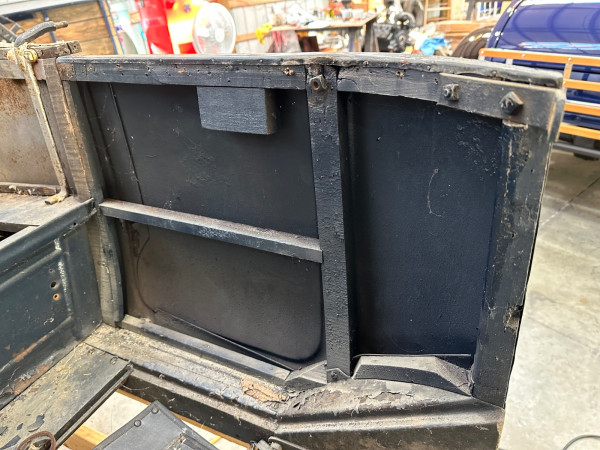

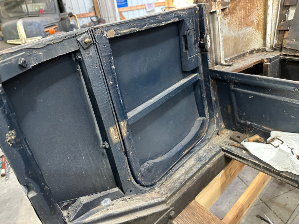

The wood is original and the upholstery did look like it may have been replaced, the seat backrest was made in three pieces, overlapping in the curved sections, as much as I would like it to be blue I will probably paint it black just to be correct. I just find it hard to believe an old repaint would have been do thorough. Art

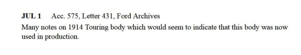

I am not much help but I have one of those very early 1914 Touring cars you mentioned, engine #312.4XX,
body by Beaudette, also known as Pontiac. By engine number, it was assembled in July of 1913 and the body is dated 13
on the front seat support wood. Mine was repainted probably in the 1950's. The paint didn't stick well on the tub center
back panel and others seem to think that what shows today is that black/blue varnish Ford used. There is a "hint"
of blue in bright sunlight. Not a distinct blue that "I think I see" in your last post. Those Beaudette early 14 style
body cars were built along with the 1913's because they solved the weak body problem Ford had with the 1913 Touring.
Attached is the July 1, (1913) note from the old Ency.

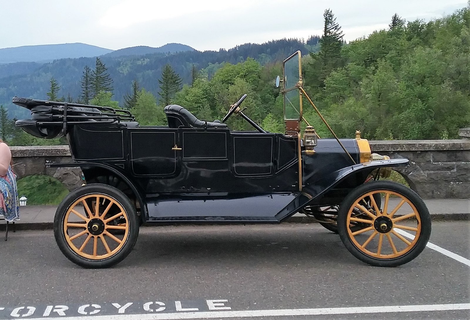

Art-
According to Arnold and Faurote in Ford Methods and the Ford Shops, bodies were first sprayed (at 80 psi) with a brown metal body primer. After drying, bodies were sanded and ready for the second coat of body priming; a blue-black coat was "flowed on" with with paint nozzles that look like hand held garden hose sprinklers. Excess paint ran off and into a drip tray and was pumped back into the system. After the second priming dries, the "color varnish" and "finishing coats" were flowed on in the same manner. Then the upholstery work was done. After the upholstery work was done, the body was vacuumed of all upholstery debris, leather, horsehair, threads, etc. body exterior wiped down than given a final "finishing varnish" applied with the same garden hose sprinkler application process. (pgs 360-368)
Arnold and Faurote have an incredible amount of detail, but also lack an incredible amount of detail, like the actual color of the "finishing varnish" Images along with the text show both 1914 and 1915 bodies.
One would expect the brown metal body primer to be sprayed all over the body, inside and outside, but what about the second coat, the black blue coat of body priming? Obviously kick and heel panels would be primed, but what about the seat frames and inside the body that would be covered with upholstery panels? Possibly. Clearly there would be no reason to put any finishing varnish anywhere except exposed areas.
In the documentation section of McCalley's book Model T Ford, The Car that Changed the World, factory letter to Ford Branches, includes a revised list of paints and order numbers. It includes, "F-115 480 3rd and 4th coat Body Spraying Blue Color Varnish, Body" (pgs 555-556)
In my humble opinion, an October build may have had black blue finish color. Fenders, running boards, and splash aprons would be black. Wheels would be blue.
Should you choose to paint your car blue, I would suggest a Mercedes color, DB 332 (ca. 1963-1967) I painted my 1911 touring this color using Diamont Uno 4635 A and am pleased with the result.
YMMV
Keith
