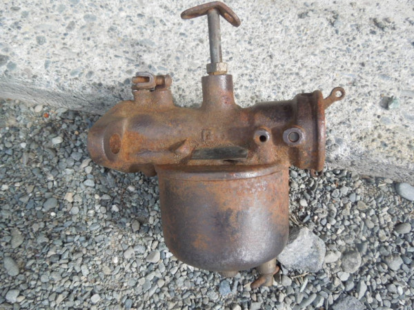

I bought this Holley NH yesterday at a swap meet and thought I might clean it up.
I have some new parts on hand, 20 - 25 spray needle etc which states NH 3-3/16 long.
Does this model have different parts or Is this suitable?

Re: Straight thru Holley question
Post by Bruce Compton » Sat Oct 12, 2024 11:03 pm
Everything is the same except that all straight through carbs came with the longer throttle and choke arms that can be replaced by the shorter ones if you want to use it on a later T ('24-'27). Both float bowls interchange as well.
Post by Moxie26 » Sun Oct 13, 2024 6:38 am
Kevin ... I agree with Bruce. When you get a chance I'm sure you'll soak that for a few days and then blow through with compressed air and just rebuild like a normal NH, you will be satisfied with the extra performance the straight through will give....... You may want to consider using the high flow intake manifold.
Post by J1MGOLDEN » Sun Oct 13, 2024 4:06 pm
Look at those two small right side holes in your lower photo.
They are very important to good operation of the carburetor.
They go down to a small puddle area on the other end and the lines have to be clear for an easy start good operation carburetor.
Most of those carburetors have to have the vehicle going over 20 mph to pick up all the gas required without the use of those holes.
Those lines are rather difficult for a "do it yourself" rebuild or overhaul.
Good luck with your home project!

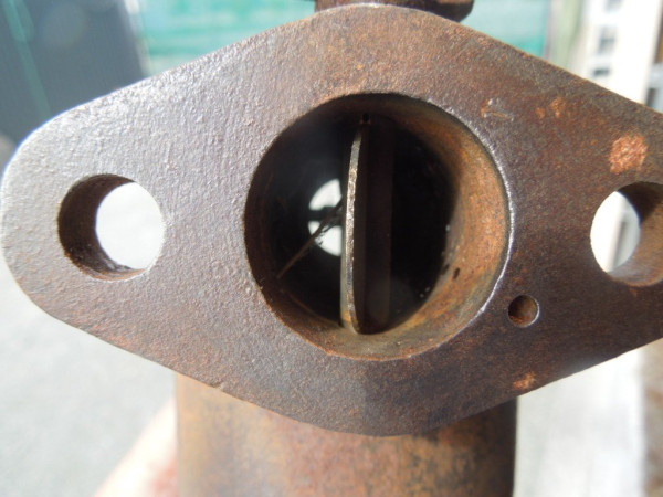

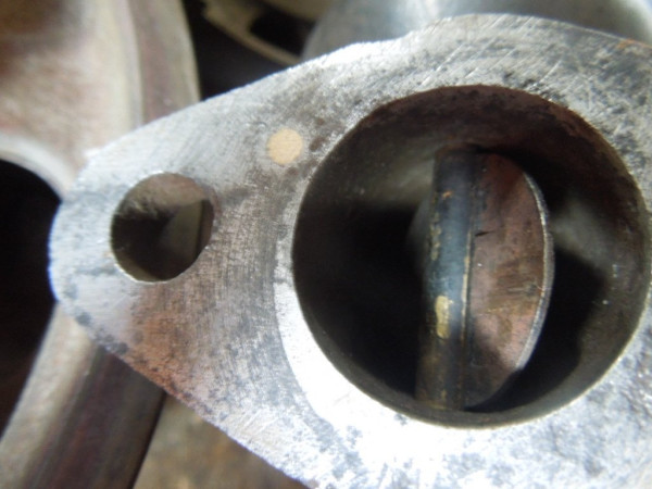

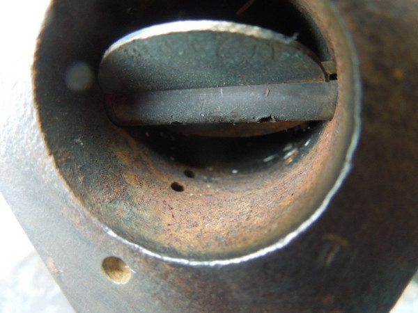

Jim - are these the 2 holes you are referring to?
I notice my UK Ford NH plus another common NH I have here also have those holes, are you saying they are not so important in the other model carbs?

Corey Walker
Posts: 671
First Name: Corey
Last Name: Walker
Location: Brownsboro, TX
Post by Corey Walker » Wed Oct 16, 2024 10:50 pm

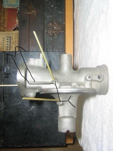

Those holes are part of the Holley idle circuit with drilled passages replacing the previous pickup tube used in the H1, G and S. The beginning of the passages begins in the mixing chamber and picks up the gas that flows through them at idle.
The H1 and G had a pickup tube that screwed onto a fitting then a passage was drilled that terminated where the 2 holes in the NH are located.
The 1913 model S used a pickup tube soldered to the mixing chamber cover that met with corresponding passenger drilled into the carburetor body.

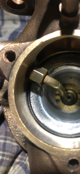

Post by MarkS » Thu Oct 17, 2024 1:16 pm

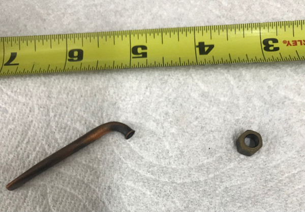

The drilled holes have another advantage. I have a Holly G that has the separate pickup tube and nut. The first time I removed the manifolds from my car I found the nut in #2 intake valve chamber and the tube in #3 intake valve chamber. Fortunately, there apparently wasn’t enough flow to suck them up paste the valves!
And yes, it was very hard to start!

Rata Road wrote:
Wed Oct 16, 2024 9:28 pm
Ok Martynn, I was going to show the Straight Thru to guy from a Carburetor restoration shop that will be here in 2 days to sort my 30 Chev carby.
After Jims comment I was considering to get him to take the Carb and soak properly then rebuild it correctly. If I do I will ask him to record the info you seek. Otherwise if i tackle it myself I will get you all the info you need and post it.
If I may, those 2 holes are very important for either carburetor. More than just soaking, they need to be cleared with the proper size drill. The holes they intersect with also need to be drilled out, which requires removing and replacing a couple of brass plugs. Hoping you & Jim will pardon my jumping in on this. :)

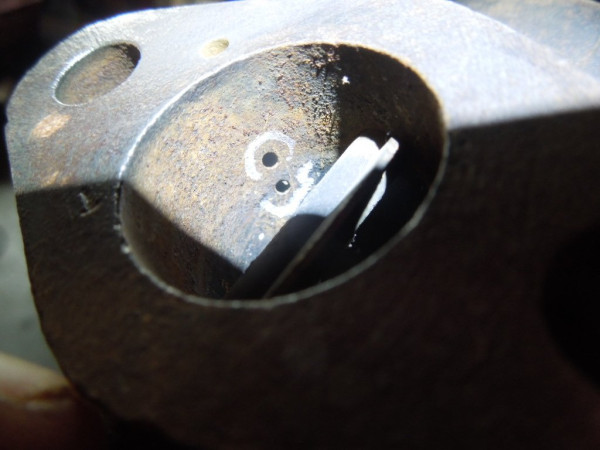

So let me get this straight, are you saying the single hole on the face plate which bolts to the manifold needs to be drilled out to enable you to access and drill clear the tube which is attached to the 2 internal holes pictured about?
Is that why the single hole on this UK made Model T Ford Zephyr NH looks like a brass plug?

Yes, correct. See Corey Walker's first photo, above. He demonstrates the course of the holes involved by inserting brass rods in them. The entry point of each hole will be identified by a brass plug.

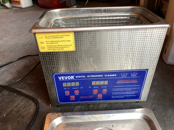

I brought an ultrasonic cleaner and motorcycle carb ultrasonic solution on amazon. Ive done a few carbs with it including my NH. The unit has a heater that gets the solution hot. I use wire strands to chase the passage holes and jet holes. Compressed air and a final blast of carb spray.
Rata Road
Posts: 210
Joined: Mon Mar 25, 2019 11:58 am
First Name: Kevin
Last Name: Weeds
* REQUIRED* Type and Year of Model Ts owned: 1923 Depot Hack, 1927 Coupe & 1914 Runabout
Location: New Zealand
Post by Rata Road » Thu Oct 24, 2024 4:24 pm
Thanks Guys,
I had a look at the ultrasonic cleaners, working out which one would hold a Carb is the question. What model/size did you use ?
RecklessKelly
Posts: 304
Last Name: Maxson
Location: Old Saybrook, CT
Post by RecklessKelly » Thu Oct 24, 2024 5:21 pm
Vevor from amazon. The inside is 9.5 x 4.5 x 4" deep.
