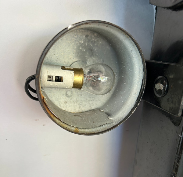

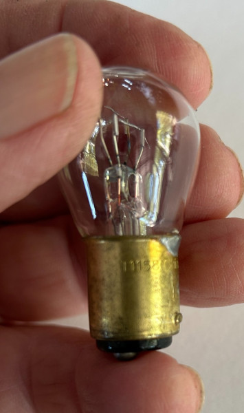

I am looking for a LED bulb that will replace the existing 1158 incandescent bulb. I have 4 Model T’s that use the same tail lights and all use the 1158 bulb. They work but I want brighter. I do not want to change to a modern fixture, I’d like to stay as original as possible. So far, I have not found a LED replacement bulb that has 2 contacts (brake & tail light), non-staggered pins on the side, and operate on 6 volts. Has anyone found such a LED bulb?[image][/image]

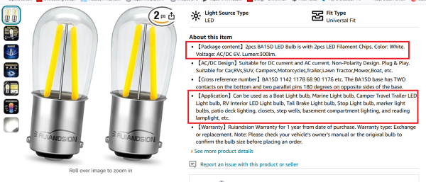

Search using BA15D LED 6v BA15D is the spec for the base with parallel pins and 2 contacts
Just one result https://www.amazon.com/Ruiandsion-Filam ... B0CLD21YLT
Look for lumens output

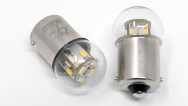

Logo Lites bulbs
LED #63  for Running/license plate lights logo Lights

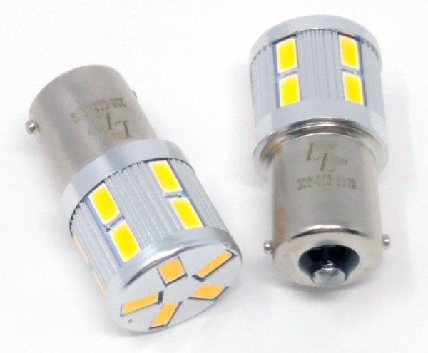

LED #1129 for brake lights from Logo Lites
