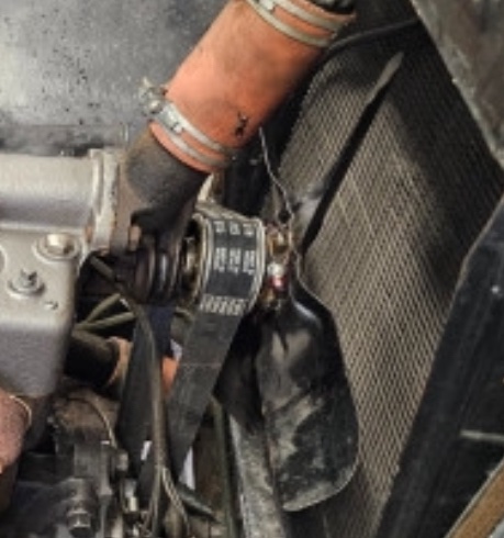

Every time while driving my grease cap on the fan hub untwists and falls off. No matter how tight I twist it on it is missing after a tour. How can I keep it on ?

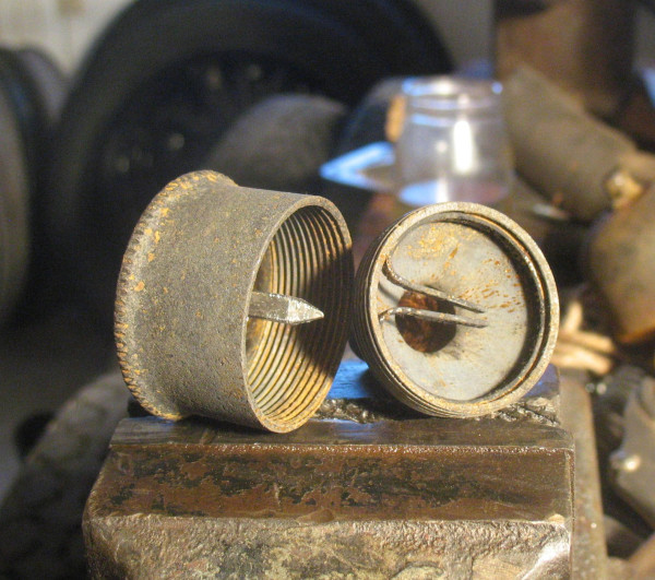

The cup, or its cover? Sometimes there is a small spring which keeps the lid from vibrating loose.

Steve, you are completely right. I have some of those grease cups with the pinchers in the middle and spike in the lid but never knew why so I did not use them. I have lost four or five caps because I did not know. Thank you.

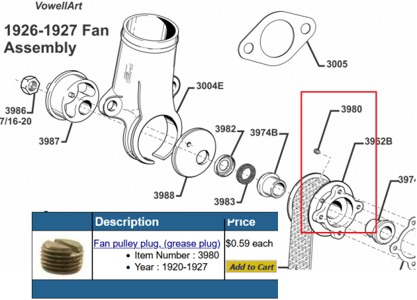

This what was intended for stock fan shaft

If the fan has a grease cap, it screws onto the back end of the shaft. The shaft is hollow, so that the grease cap will force grease into the void between the two bushes. Oil is for the later aluminium pulleys with the brass plug.

I had close to 20 proper grease cups but none with the clips on the inside to keep it from untwisting so I bought 3 from eBay. Thanks Steve.
