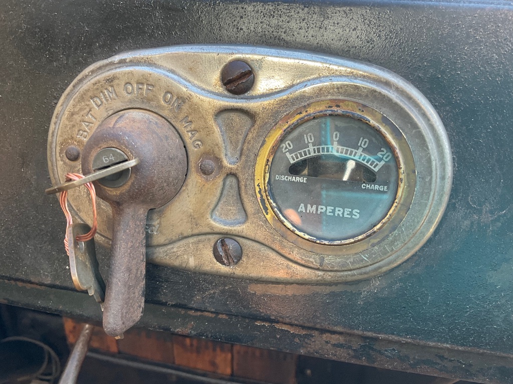

Looking for input on an electrical issue. Running on either BAT or MAG, my ammeter is showing 20A charge. Light switch is off and lights not yet connected. I removed the cutout cover and the points are clean. Voltage at a high idle is 8.9v at the GEN terminal. I realize that I can adjust voltage down to 7.2V with the 3rd brush, but am wondering what might cause such a large charge rate? When reversing the ammeter terminals I get a 10A discharge. Until I figure out the issue, I have removed the cutout and grounded the genny.

Yes, it is a repop Ford logo small dia. Ammeter complete with MADE IN CHINA sticker proudly plastered on.

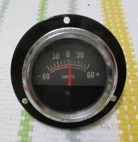

The first test is to reverse the wires on the ammeter and see if you get the same readings both ways.
The best choice is to buy an ammeter adapter that is used to attach the small 1926-27 ammeter in the earlier ignition switch panel.
Then, you cut or grind out the center section and any modern two inch ammeter will fit and work.
That is especially good, if an alternator has been installed that will provide more than 20 amperes.
This is one of my examples.
