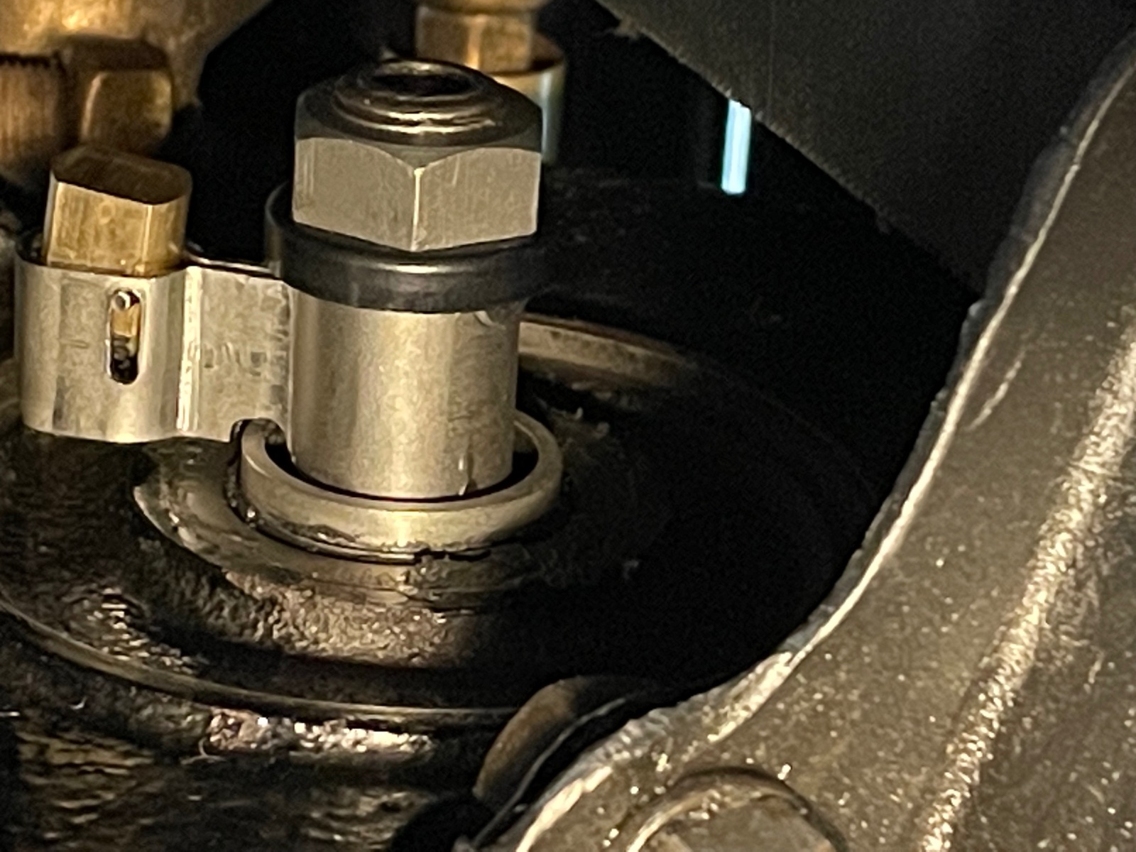

We just took off the old roller timer from our 1913 Touring and put on a New Day Timer purchased recently from one of our outstanding suppliers. With the timer spring tightened down, the timer wobbles badly and the timing adjustment lever on the steering column will not stay on one place. We followed the instructions provided. Anyone experience this and have a fix? Maybe this was addressed before on the forum but i couldn't find it. For now, we put the old roller timer back in. We have had a New Day on our '25 coupe for years without any issues. Thoughts?

I had that same issue. The problem was that the oil seal I have sticks up and I had to cut a notch in the rotor it to make some clearance. It was a really bad wobble and it was grinding away at the timer. I am not sure what kind of seal is in my engine because it was that way when I bought it and it does not leak a drop so I am not going to touch it.

The brush is sticking out further than the timer contact face.
To see how much, make a simple gage. A strip of thick paper strip trimmed to fit from the timer face to the mounted edge around the total inside diameter.
Take your gage & place in place of the timer in the timing gear cover. Eye sight or straight edge across the edges with the brush fully compressed. The brush must sit lower than gage the edges. It does not now.
You can look into the oil breather to see the type of cam gear.
The brush holder, brush or gear nut can be modified to fit. The brush holder should be seated down on the cams machined edge.
The felt & brass plate isnt good enough to keep ALL the oil out. That timer has to be run dry. Put a modern lip seal in.

What I see is the timing gear nut is sitting to high, not allowing the brush holder to seat on the cam.bdtutton wrote: ↑Sun Oct 20, 2024 11:58 amI had that same issue. The problem was that the oil seal I have sticks up and I had to cut a notch in the rotor it to make some clearance. It was a really bad wobble and it was grinding away at the timer. I am not sure what kind of seal is in my engine because it was that way when I bought it and it does not leak a drop so I am not going to touch it.
The brush holder modification got the holder to seat properly.
The nut used should have been the shorter one. The gear used would have been thicker than stock so the lip sticks out further. The nylon gears come with a shorter nut for example. But the solution works.

When I put the New Day on my T it was doing the Hula. I ordered two brass shields and cut the middle out to fit over the modern seal. The brass shields act as a shim to bring the timer a little away from the cover, then my New Day stopped doing the Hula.
