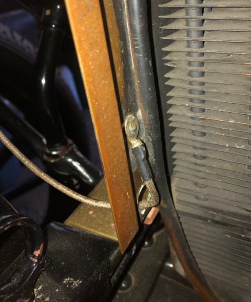

Ground wire from headlamp socket to radiator stud as Dan posted - this is my father's 1917 Ford.
From the factory, supposedly the ground wire from the headlight was actually soldered to the radiator support. Don't know if that was how it was done on the Rip Van Winkle 1917 touring - I have a number of photos of that car so I'll have to look to see if any show that.

This worked for me, and I think it's "approximately correct". The wire on the right brings magneto current that has passed through the right headlamp and feeds it to the left headlamp. The wire on the left brings current from the left headlamp to ground at the radiator stud.

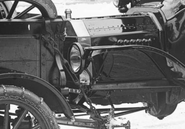

Here's a 1915-16 Ford factory photo showing a method of towing. The ground is somewhere else on the car, not on the radiator stud.

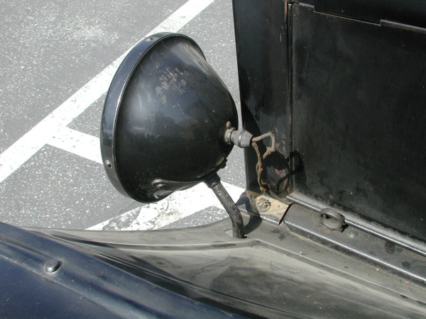

The connection of either the headlight adjusting screw and/or the lamp socket to the headlight bucket should be checked.

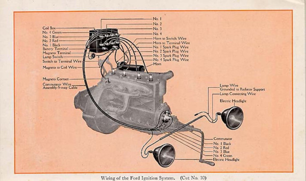

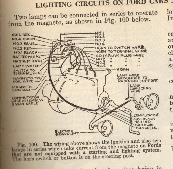

One question: Is the wiring for the lamps in series as the diagram says
Corrected the diagram Ground wire connected to radiator support

Your diagram does not apply to a stock 1915 Ford.
Posts: 6609
Woops wrong diagram thanks for noticing add the correct one above

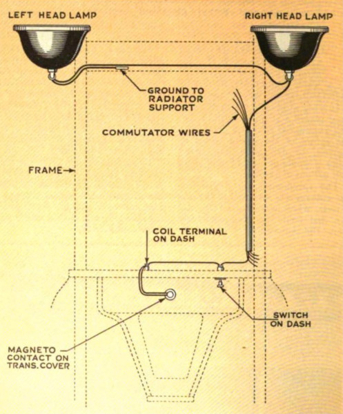

No questions bout it: The 1921 diagram says the Head Lights are grounded through the lamps.
Larry asked about 1915, not 1921 or later. They're not all the same.
1915 headlamps are wired in series, like old time Christmas tree lights. Both headlamps are powered by the fifth wire in the commutator cable. The current comes directly from the magneto through the light switch on the firewall.

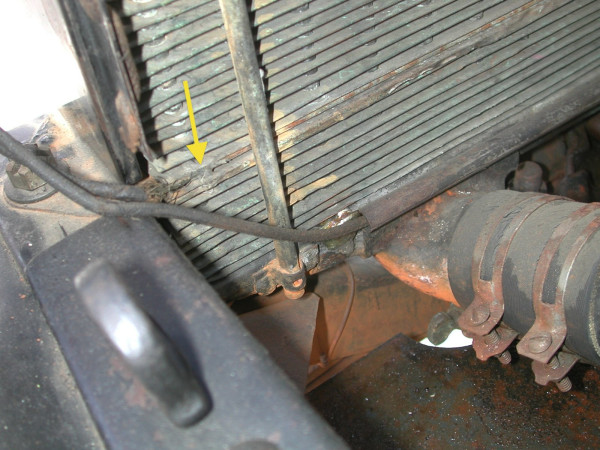

Here are photos of the "Rip Van Winkle" 1917 touring - click on photos to enlarge. This car has a June 1917 motor number and was most likely assembled in the downtown Minneapolis plant.
The wire is grounded to the radiator support strap. The yellow arrow points to solder blob which actually extends downward past the support strap and onto two or three fins below.
Why Ford Motor Company engineers decided that the headlight should be grounded in this manner is a mystery.

Post by Erik Johnson » Tue Oct 22, 2024 8:03 pm
Credit should go to Trent Bogess.
It was due to one of his posts years ago that I became aware that the ground wire was soldered to the radiator cross bar.

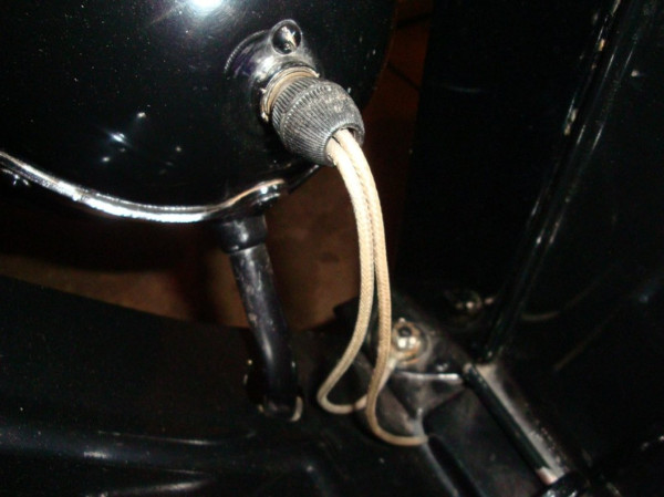

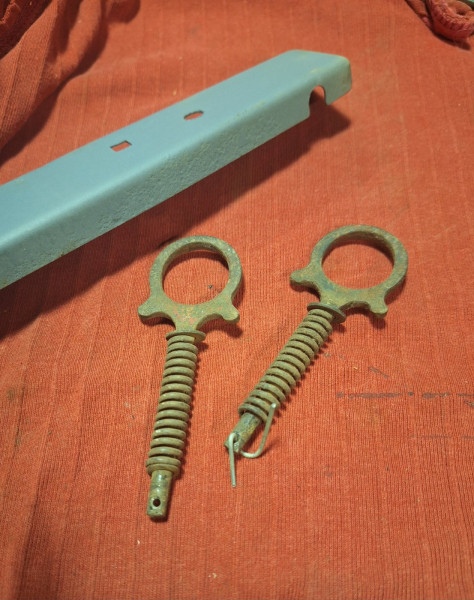

Eric's second photo of the Rip van Winkle 1917 car raised my interest. The wiring exiting from the engine compartment looks like a problem in the making. Perhaps it should be exiting from under the hood shelf via the cut off corner on the outer edge of the shelf, rather than where it is shown.
This hood shelf is another variation to the low radiator type. I have seen one with a small single wire hole punched in the top surface of the shelf at the front. This one had a raised ring around that hole.
Then there was this one.
I was given a pair of these, with the odd shaped hood hooks. The inverted U shaped relief in the outer side of the shelf is likely there to accommodate two wires on later cars.
Then there was the later type with the large hole on top, and the hard rubber grommet to stop the wires chafing on the panel.
So that makes four variations now.

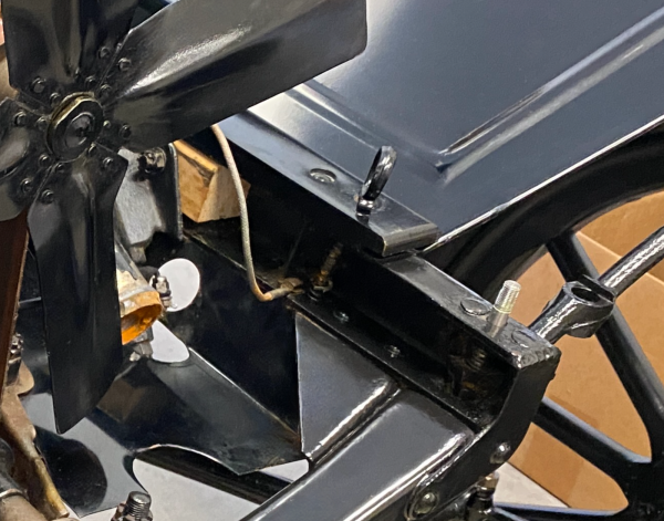

Post by Trford » Fri Oct 25, 2024 9:13 am
My 1915 Touring headlight ground wire. Note: cross tube and wire not shown. Needs to be repaired. I don’t know this to be original. For your reference.
