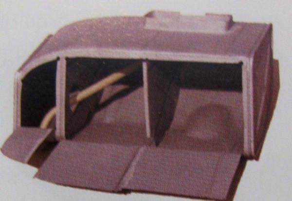

I have done all the regular things over the years, put cardboard behind, yard stick pieces, tightened and so on. The tank baffles are still soldered in and were pinned years ago with the solder. What have you all done to stop the drumming?

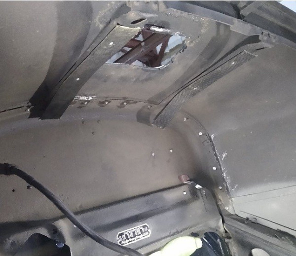

Has nothing to do with the muffler! Are you sure the noise is coming from inside the tank? There should be two strips of webbing material at the top and a fiber panel behind it. The straps which hold it in place hook in the area above the tank below the windshield with threaded end through the firewall with nut on the engine side. They should hold the tank tight. I am presuming the tank is in the cowl. Some models have it under the back seat.

Hows your over flow pipe? Could it be hitting a baffle

Did I miss it? But I did not hear anything about the top straps.
