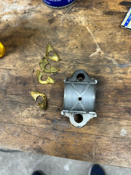

Over the course of the summer we've noticed an intermittent faint knock in our 1919 T. A local group member was kind enough to come over and through shorting out one plug at a time isolate the noise to the #4 cylinder. Since the car smokes at times & the last record I have of it having any major engine work was in 1963 I figured that it was time to pull the engine this winter and go through it. I decided that since the noise hasn't changed in the 2 summers that I've driven it, I would go ahead and go on my first group ride. The ride was in a "hillier" area than I anticipated & now the knock is louder.
I decided to go ahead and pull the #4 rod cap and see if I could remove some shims to allow me to run around some until it was time to pull the engine this winter. So far I've found that the service manual times for this operation is quite humorous in that I've already spent that much time just trying to get off of the creeper.
I was surprised to see that it has dippers on the rod caps. Here's a picture of the inside of the #4 cap. After I moved the piston up in the bore I could see that the Babbitt on the rod end is also grooved the same way and there is a hole exiting by the rod stem.
This morning I was finally getting close to having the correct clearance when I did what I was afraid I'd do: I dropped the cap & shims as I was trying to get it back on. I had made an aluminum foil pan to try to avoid this but the shims from one side of the cap fell down into the oil pan. I can see them down in the pan using a mirror.
Short of buying a brass magnet, has anyone had any success in getting shims out in a similar situation? Or is it time to bite the bullet and pull the engine?

A "brass magnet" is a mythical tool that is usually used as the thing you ask the new guy to go look for in the machine shop.
I should have clarified this. Each side of the rod cap was shimmed .054". Since I'm using the shims from Snyder's that are .035" (I think), I have to use part of 2 shim packs on each side of the rod cap. So I have 2 shim packs laying in the front of the pan down towards some sort of riveted plate by the drain.Mark Gregush wrote: ↑Sat Nov 02, 2024 12:56 pmJust one leaf of a shim pack? What brass shim, must have dropped it somewhere under the car. Oh well I will find it later. Personally if I was going to pull the engine this winter and couldn't see it to pull it out, don't know if I would worry about it. Or you could try flushing it down to the drain and pull it out.
The more I think about it, I think it's just time to go ahead and pull the engine. It's November in North Central Ohio, so I don't think there are a lot of good days that will be lost in driving an open car at this point.
