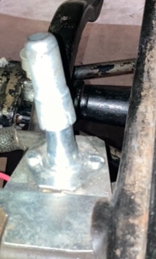

Is there an extension on my starter switch? It is really high and takes a lot of effort to step on it. I saw some photos of some that had just a short button on top. If it does, how can I remove it without breaking the switch? I tried pulling on it a little but it didnt move.

John, it is an extension. It jams on over the top of the switch. You may be able to prize the extension at the splits in the side to open it up a little so that it may be easier to remove. Your switch is a reproduction. They are notorious for the plunger breaking free of the base cover, so you will have to be gentle with it.
There is nothing like a sturdy original switch. I would be looking for one as a replacement. They are rebuildable. They come up for sale from time to time on the parts forum, or you could advertise to buy one.

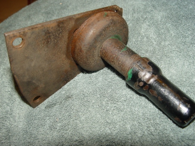

There is an extension on your repop switch, sometimes that universal fit footswitch isn't tall enough depend on your year, the 26-27 improved car uses a lower switch thru the floorboard, the earlier cars need the extension to go up thru the heel panel.
Ford original switch with extension.

I will look out for an original but in the mean time I will try prying the slots to loosen it up.

The top of the switch should just clear the floor board to make contact - about 1/2 - 3/4 inch. Pushing down on an angle will cause the front contact to touch & not the rear, then one presses harder and more bend in the metal base.

NOTE: The extension is optional. Only need the a minimum of the top of the switch to be above the floor board.

I see they come with the extension, someone put it on whether it was needed or not but its way too high.

I had to mill the sides of the extension until it was really thin in order to pull it off, but I got it!
