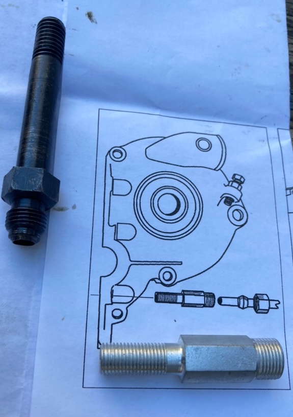

My oil line has a few worn spots on it and the mag bolt was leaking through the terminal so I picked up a new oil line kit. My old line ran along the right side and under the generator to a bolt/fitting horizontaly into the block. The new kit instructions show removing a timing cover bolt on the left side under the spark rod and replacing with a supplied steel bolt/fitting pointing straight down.
Looking at tube placement, It seems like the left side is safer, away from the exhaust pipe but the tube may conflict with the spark rod if on the left side. The old tube bolt/fitting is an oddball having a hydraulic taper connection on one end and its worn at the taper. I doubt I could find a replacement. I could replace that with a standard bolt if I went to the left side. Is there any big difference either side for oil flow?

Left side is fine, the fitting pours the oil on the timing gears.
Careful fitting of the timer rod won't cause any problem with that oil fitting bolt.

As far as I know, which side the line is on doesn't matter. It should be kept as short and straight as practical to allow full flow and prevent clogging. Remember that you have very little pressure to work with, and oil has viscosity. I'd want a 3/8" ID line to allow free flow.

I'l go with the left side. It looks like it will be tough getting a wrench on the coupling nut but the routing doesnt look bad. The line is 5/16 OD. I picked up a farrell and plan on making a brass plug for the bolt under the generator. The full flow system looks great, maybe a future project.
